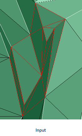

This tool is used to create a body using a set of shell elements. The shell elements are removed from the original body and created as a new shell body. The original and the new bodies are connected by a shared edges.

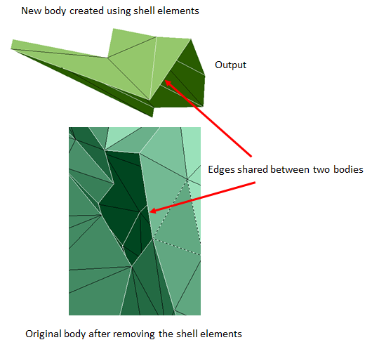

  • Fill free edges and make shared faces

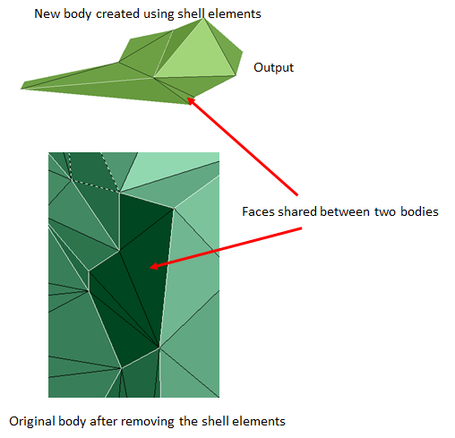

    If this option is ON, the faces will be created using the shared edges. The new faces will be shared between original and the new bodies.
Example: Fill free edges and make shared faces option OFF
Example: Fill free edges and make shared faces option ON
