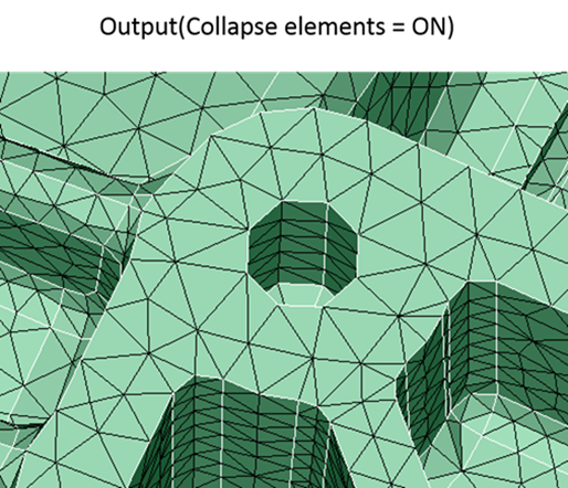

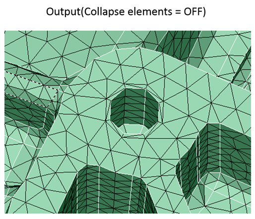

- Collapse elements
All the elements in the chamfer faces will be collapsed out if this toggle is enabled.

| Input | Output(Collapse elements=OFF) | Output(Collapse elements=ON) |
