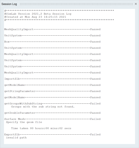

The log of all the user performed operations in SimLab will be written to a file in ProjectDir folder which is available under %Temp%\SimLab\SimLab_2021.2\ProjectDir.

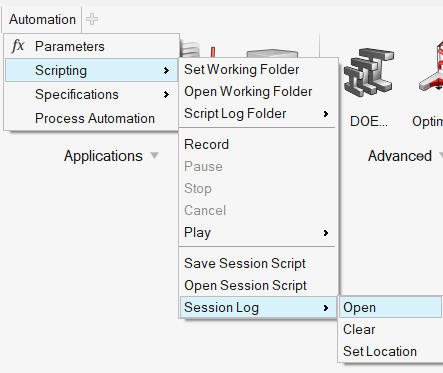

Open
This option will open the session log, which contains the status of all operations. This feature will help to check the failures when operations are performed through the Custom Ribbon/GUI script.
Clear
This option will clear all the logs, it will help to check the status of operations performed from that point.
Set Location
Session Log file location can be changed using this option. Default location - %Temp%\SimLab\SimLab_2021.2\ProjectDir\SimLabSession_LogFile.txt.
