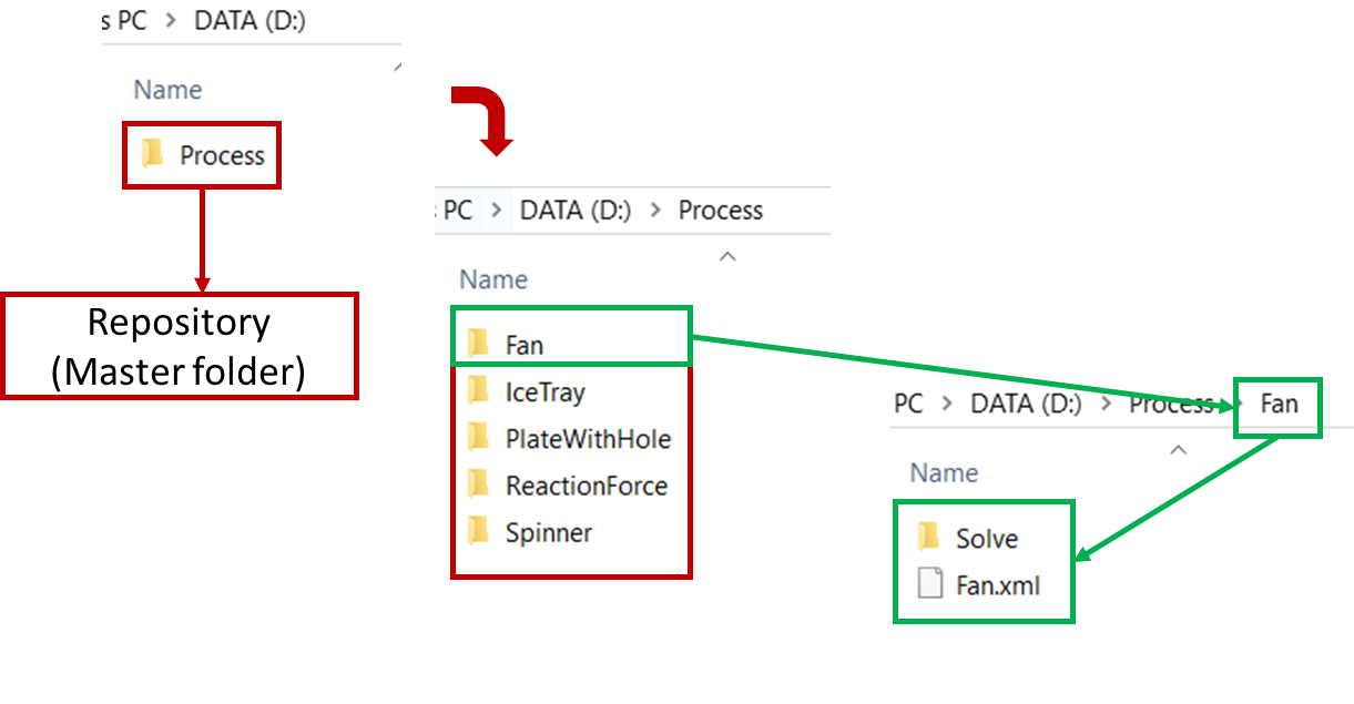

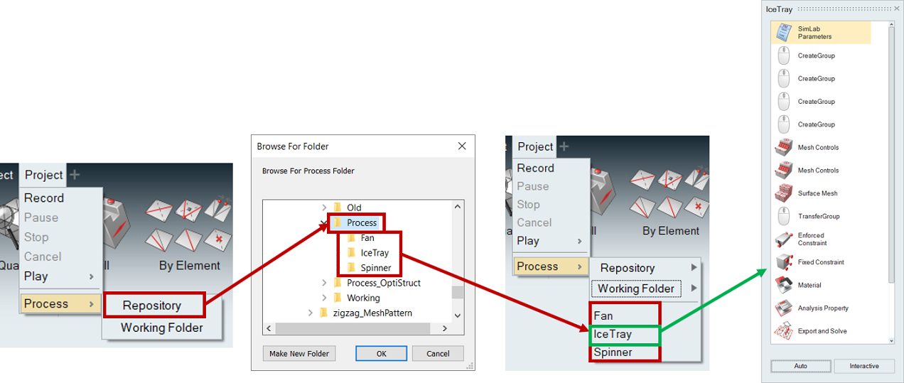

When env SL_PROCESS_MENU is true, the process menu will be visible. Process option is used to list the standardized script (recorded using session script *.xml approach) and it can reuse for similar type of geometries. Below are two options available under the process.
Repository
Repository is a master folder where the standardized script will be available. Repository folder contains sub folders. Under each sub folder session script will be available.
Note: Sub folder name and the session script name should be same. Otherwise it will not list under the process option.

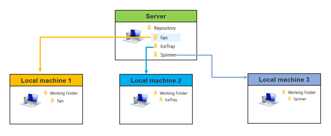

Working
Working folder will be set in the local machine. This will take a copy of the selected process from repository folder and place it in the local machine working folder. Under the working folder, all the related files like output database, solver deck etc will be stored under the working folder.
