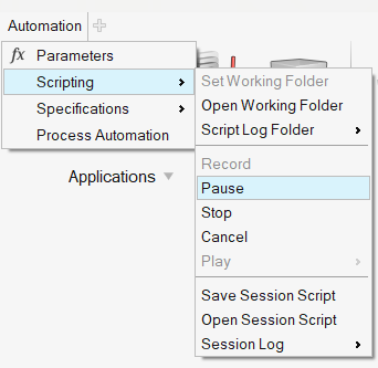

Pause button will do a temporary stop of the recording. To continue the recording, click on the Record button again.
Pause button will be useful for some of the following case.
While generating mesh for a CAD model which contains distorted face in the CAD. This results intersection after meshing. This type of bad face is not expected in other CAD models. In this case, after meshing recording can be paused and do the manual operation to resolve the element intersection and then continue the recording. In the script, manual operation to resolve the element intersection is not recorded.
