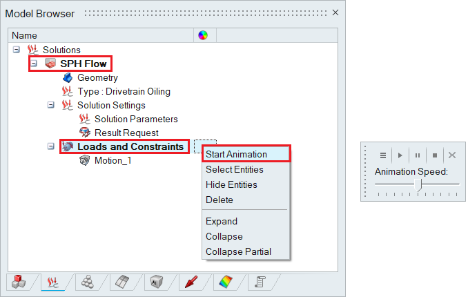

The Motions defined in SPH Solution could be previewed to check whether the motion definitions are correct.
The option is available in SPH Solution > Loads and Constraints > Right Click > Start Animation.

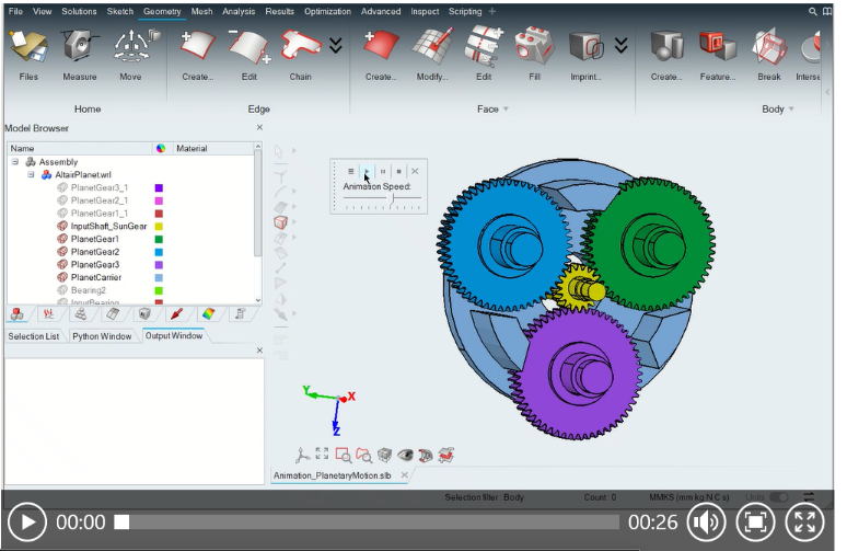

Animation is supported for the following motions

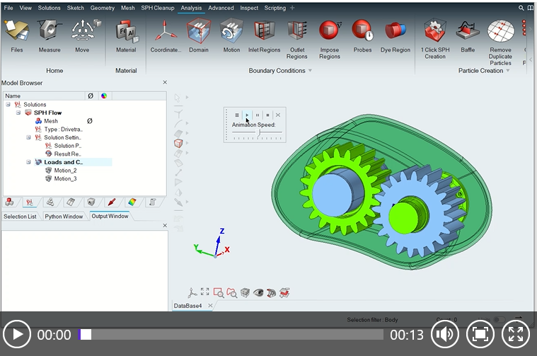

  • Rotation

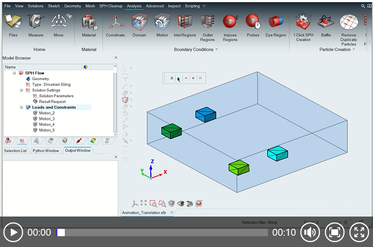

  • Translation

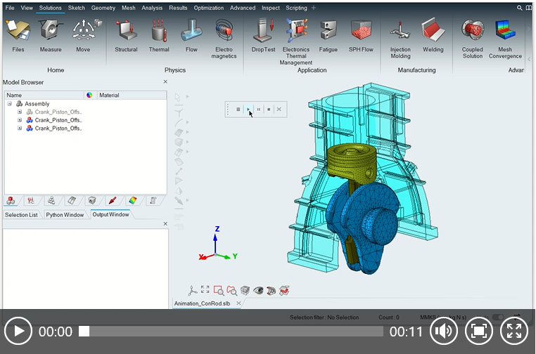

  • Con-Rod motion
  • Planetary motion
