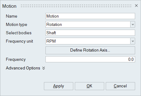

Rotation
motion_type = ROTATE_AXIS.Defines a rotation type motion
  • Frequency Unit – Rotational Frequency may be defined using revolutions or radians, per second or per minute.
  • Initial Frequency – Rotation Frequency at Start Time, usually 0 unless creating sequential motions.
  • Frequency - Rotation Frequency which will be reached after damping time.

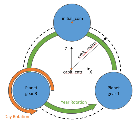

Planetary
motion_type = PLANETARY. Allows definition of planetary gears. NB – normally accompanied by a Rotation motion for the carrier.
  • Year – the main orbit of the planetary bodies.
  • Day – the local rotation of the planetary bodies.
  • Carrier arm reference frame – A flag to specify whether the angular velocity is defined in the inertial or carrier reference frame. If the toggle is OFF, the day and year rotation axes must be parallel. Non-parallel axes can be defined when the toggle is ON.

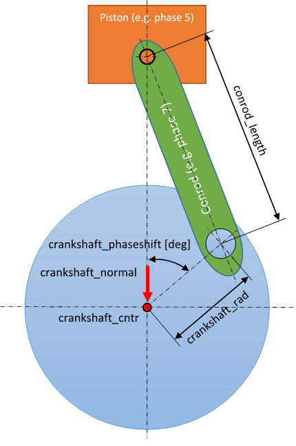

Conrod
motion_type = CONROD. Allows definition of a piston and conrod mechanism. NB – normally accompanied by a Rotation motion for the crankshaft.
  • Crankshaft Axis – Rotation Axis of the crankshaft.
  • Piston Axis – Piston sliding axis (vector must point towards crankshaft).
  • Journal Axis – Location of the conrod journal bearing axis.
  • Crankshaft Phaseshift – angle to define Conrod starting position, based on angle from crankshaft_normal (TDC).
  • Conrod length – conrod length between wrist pin and journal bearing centers.
  • Piston Offset – offset distance from the piston centerline to the crankshaft centerline.

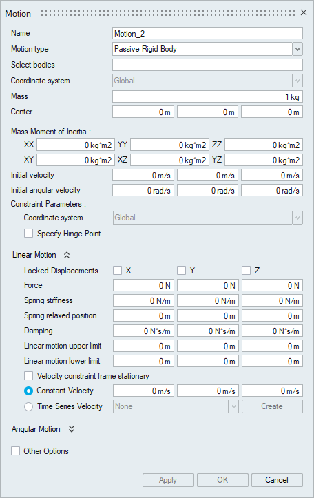

Rigid Body
motion_type = PASSIVE_RIGID_BODY. Defines a 6-DOF rigid body motion for a body freely interacting with the fluid. Constraints, forces and damping are available for each translation and rotation component.
Coordinate system – If a local coordinate system is defined in SimLab, it can be selected in place of the global coordinate system. If defined, the motion XYZ parameters use the LCS, not the GCS.
Mass, Center and Mass Moment of Inertia are automatically calculated when a body is picked, using the density from the assigned material.
Initial velocity specifies the body’s velocity at time = 0.
Constraint System – A local coordinate system can be selected specifically for the constraint system.
Hinge point – if the body is to rotate around a different point than the center of mass, the hinge point can be defined (together with constraint system) to define the motion.

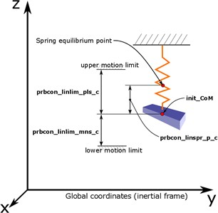

For both linear and angular motions, there are nine parameters each to specify. These parameters are optional and only need to be specified when needed:
Locked Displacements – When the direction is ticked, the corresponding DOF will be removed.
Force – Specify an external force acting on the body (eg an actuator) in each axis.
Spring stiffness – Define a spring stiffness resisting displacement in each axis.
Spring relaxed position – Used when there is pre-deformation of the spring. This specifies the equilibrium point of the spring.
Damping – Define motion damping in each axis.
Motion upper/lower limit – These parameters are used to restrict the range of motion (eg a hard stop) available in each axis.
Velocity may be specified in each axis either as a constant, or by using a time history file (time, X vel, Y vel, Z vel).
