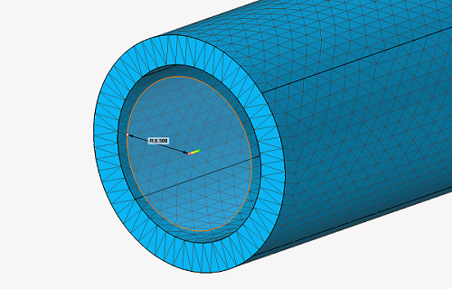

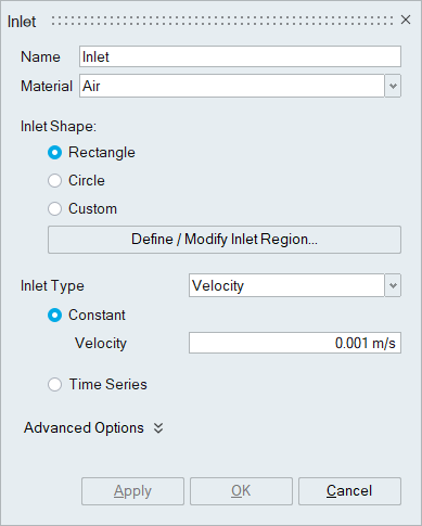

Inlet can be defined anywhere inside the domain using rectangle, circle and custom shapes.
Inlet regions can be defined in rectangular, circular or custom shape. The only limitation to the inlet regions is that they must be planar, even in the custom shape or arbitrary orientation scenario.

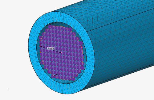

Inlet Stencil
A stencil is created for the inlet region which behaves as a source of particles. This is exported as a .txt file for the inlet region containing the coordinates (x, y, z) of the particles which are to be inserted into the domain.
The spacing of the stencil must match the dx value used for the rest of the simulation.
IMPORTANT – When the stencil is generated, it will be placed in a Model named InletRegionsProbes.gda – the stencils must remain in this model or they will not be exported correctly. This model is always exported to the .cfg, regardless of whether it is displayed during export.
