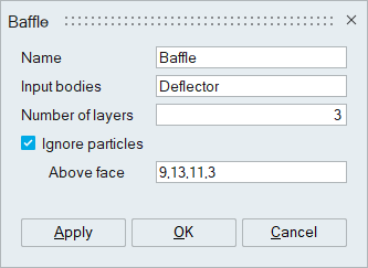

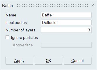

Name
The user given name for the boundary condition.
Input bodies
Input baffle bodies. Baffles are thin sections/sheet bodies.
Number of layers
A specified number of layers of particles are created inside the volume.

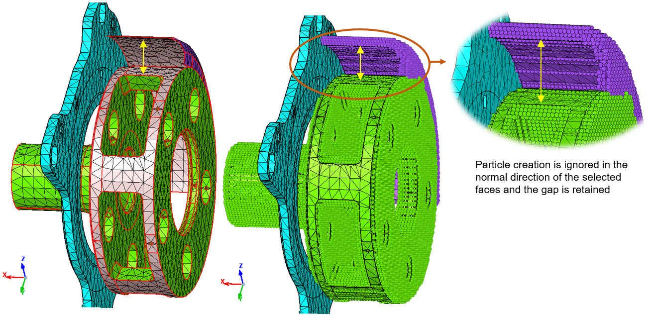

Ignore Particles
This option is used to ignore the particle creation in the normal direction of the selected faces.
