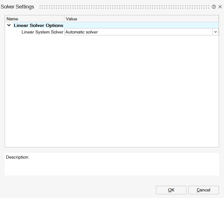

The Solver Settings allow the user to set the Flux solvers options which will be taken by Flux (in batch) to solve the current solution.
Linear Solver Options

The automatic solver bases its decision to use the Direct or Iterative solver on the solution type and the number of unknowns, as summarized in the following Table:

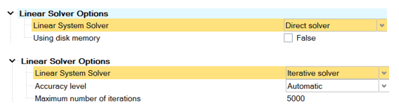

This section targets advanced users and wants to help understand what solver parameters do. Here are the solver options for Direct and Iterative solvers:
The Direct solver option available consists in using the disk for the solving in addition to the RAM. This option is very useful since it allows extending the amount of usable memory. However, using the disk implies slower operations since disks are significantly slower to compute i/o operations. If the disk memory usage is checked and no directory is selected, the default scratch directory is taken.
On the right-hand side figure, two options are displayed for the Iterative solver: the precision level (or threshold) and the maximal number of iterations. The automatic accuracy level is based on the problem type. It is possible to select a High accuracy level to ensure the result quality but it will lead to slower computation. The maximal number of iterations field allows to set a limitation on the solving time. Increasing the value can lead to more accurate results but with slower computation. Reducing the value can lead to faster computation but with reduced accuracy.
