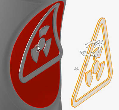

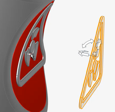

Drape
Drape one or more parts over a surface.

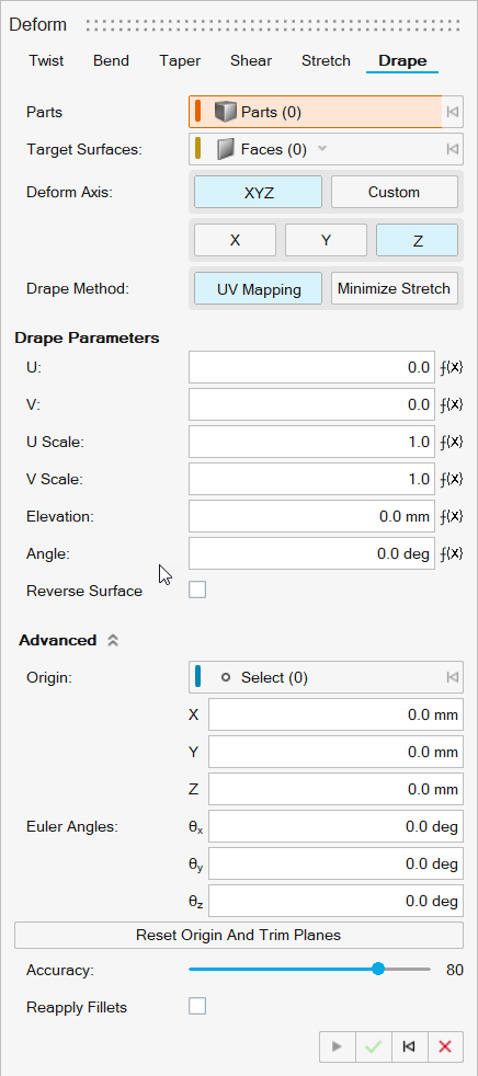

  1. On the Geometry ribbon, select the Deform tool.
  2. In the guide panel, select the Drape tab.
  3. Use the Parts collector to select one or more parts that you want to drape.
  4. Select the surface where you want to drape the selected parts.
    Tip: Click the down arrow to choose whether you want to select faces or surfaces.
  5. Select a Deform Axis:
    • XYZ: Deform the parts with respect to the selected x-, y-, or z-axis.
    • Custom: Deform the parts with respect to the linear edge or axis you select with the Deform Axis collector.
  6. Select the Drape Method you want to use:
    • Select UV Mapping to position the part on the target surface using NURBS and Parasolid parametrization. This method is more likely to result in distortion of straight lines in the UV plane.
    • Select Minimize Stretch to use meshing to position the part on the target surface. This method minimizes distortion and stretching.
      Note: When working with periodic surfaces, use UV Mapping.
  7. Adjust the Drape Parameters:
    Option Description
    U Enter an offset to move the deformed part in the U direction.
    V Enter an offset to move the deformed part in the V direction.
    U Scale Enter a scaling factor to scale the deformed part in the U direction.
    V Scale Enter a scaling factor to scale the deformed part in the V direction.
    Elevation Enter an offset to move the offset the deformed part from the surface.
    Tip: You can also drag the Elevation handle to adjust the elevation offset:
    Angle Enter an angle to adjust the position of the deformed part on the surface.
    Tip: You can also drag the Angle handle to adjust the roation angle:
  8. Select Reverse Surface to drape the part on the opposite surface.
  9. Configure the Advanced options:
    Option Description
    Origin Select Origin: Select a point as the origin for the deformed part.
    Euler Angles
    X
    Enter the x-coordinate of the origin.
    Y
    Enter the y-coordinate of the origin.
    Z
    Enter the z-coordinate of the origin.
    θx
    Enter the global x rotation angle.
    θy
    Enter the global y rotation angle.
    θz
    Enter the global z rotation angle.
    Reset Origin and Trim Planes Reset the origin and the trim planes to the default positions.
    Accuracy Modify the tolerance. The maximum value is 100%. Changing the Accuracy [%] may slow down the operation or cause it to fail.
    Note: If a deformation fails, decrease the Accuracy setting and try again.
    Reapply Fillets Reapply the fillet operation.
