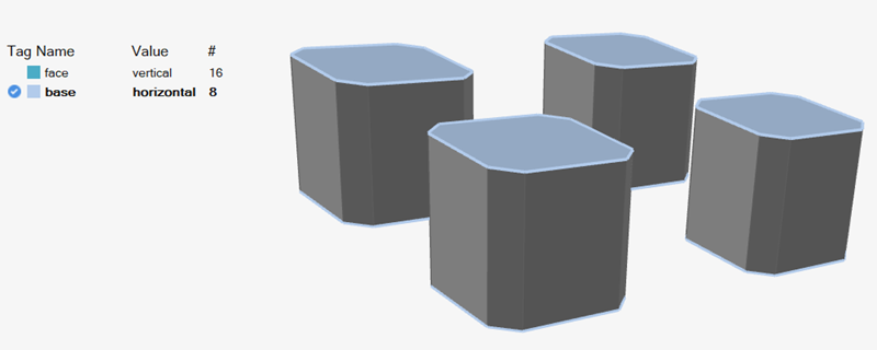

Click a tag in the legend to select it. In the following example, the
base tag is selected.
While holding down Ctrl, click entities in the workspace
to add or remove them from the tag.
The # column indicates how many entities are assigned to each tag.Note: An entity can have multiple tags assigned to it, but you can only select a single tag at a time in the legend.

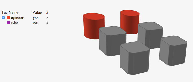

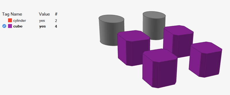

Query Tags
Display entities with the selected tag name and value.
On the Geometry ribbon, select the
Tags tool.
Note: The tool may be hidden in the dropdown menu. To access the dropdown menu, you can do one of the following:- Select
at the lower right corner of the currently displayed tool.
- Click and hold the currently displayed tool.
- Select
Click a tag in the legend.
Entities with the selected tag name and value are shown using the tag color:

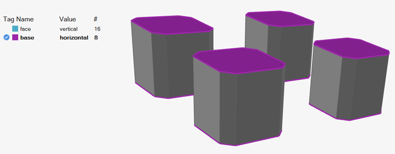

Change the Tag Color
Change colors used to display tags and their associated entities.
Tags tool.
- Select
Right-click a tag in the legend and select Change
Color.
A color picker is displayed.
Click the color you want to assign to the tag. The selected color is also used
to display the tag's entities.
