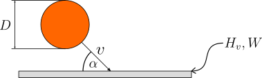

The Oka or Impact Wear contact model extends any Base Model to give an estimation of erosion depth for Geometry surfaces due to particle impacts.
This model originates from the work by Oka and Yoshida (Oka and Yoshida, 2005). Erosive wear occurs when particles impact equipment surfaces. This type of wear can be modeled using the widely adopted Oka wear model (Oka and Yoshida, 2004), which predicts the volume of removed material due to particle impact as a function of the particle size, impact velocity, and impact angle. This model takes only two inputs - the Vickers hardness of the worn material and an empirical wear constant. The results are provided in terms of wear depth on Geometry mesh elements similar to the Archard Wear model.
