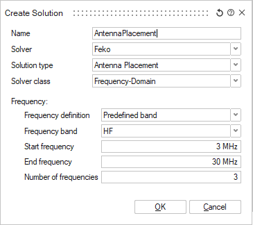

  3. Define an antenna placement solution.
