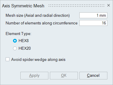

Avoid spider wedge along axis
The output mesh can contain hex and wedge elements. Turn this toggle ON to avoid wedge elements along the axis of revolution.

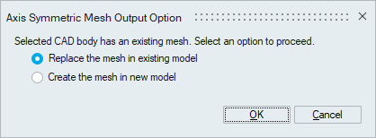

- CAD Body: The below dialog will prompt the user to select the output option if an equivalent mesh is already present. For more details, please refer Mesh output options for CAD body.

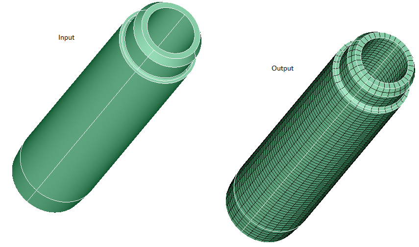

Example: 360 degree revolved axis symmetric body

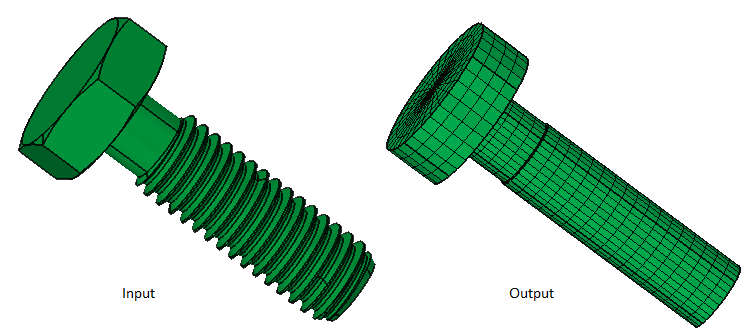

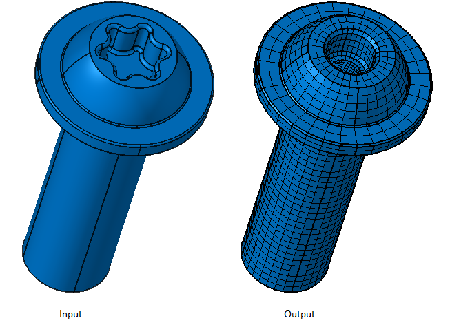

Example: Screw
Example: Threaded screw
The screw threads are simplified to cylindrical surfaces using the thread root radius.

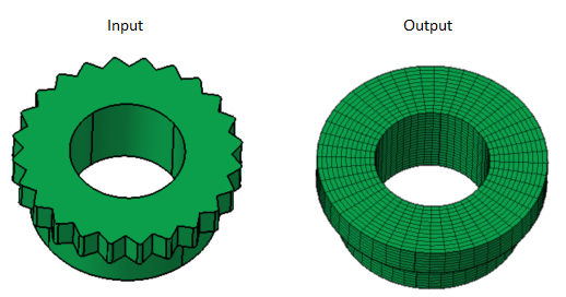

Example: Cyclic symmetry body
