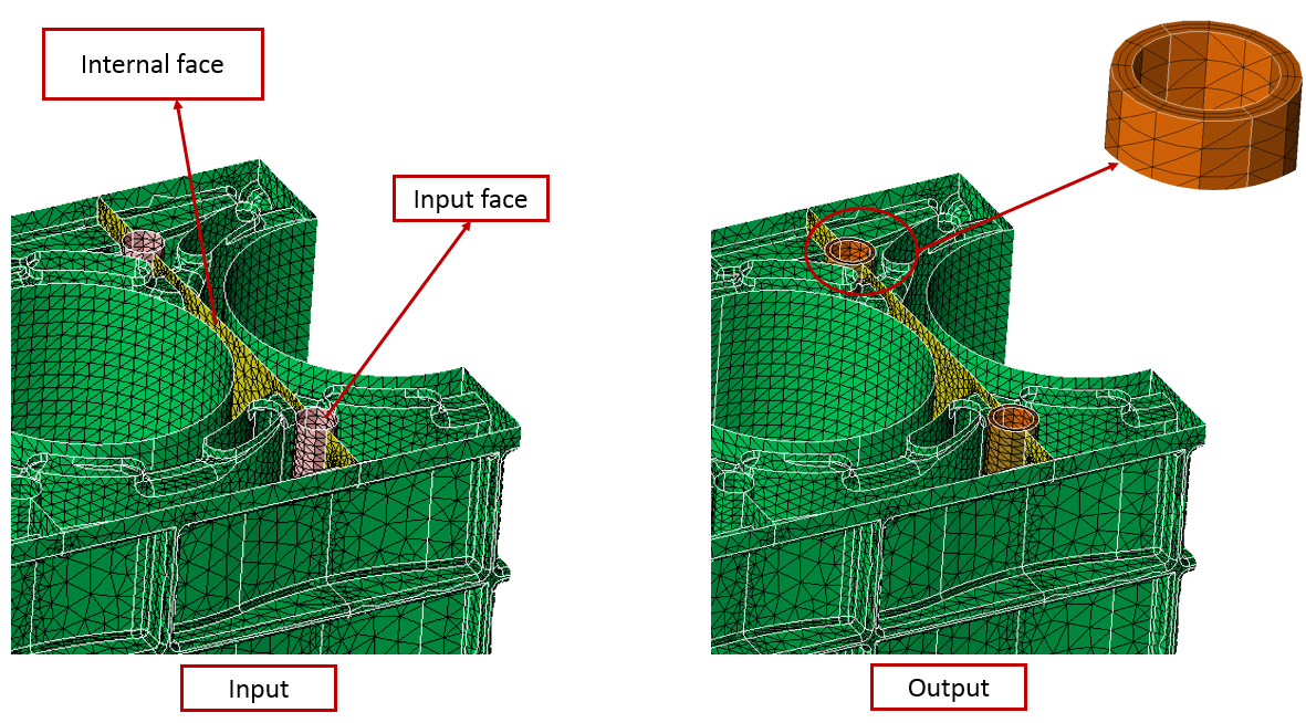

The Layered elements tool can be used to create a layer of tetrahedron, penta or hexahedron elements from the given faces for the specified magnitude. We can give the faces from solid body also. When give faces from shell body, it split the body into two. One body contains volume mesh(layered elements) and the other body contains the shell faces.
- This tool is supported for faces from the single mesh body.
- If input faces contains only tri elements and create body for each layer toggle is OFF, then the volume mesh body and the shell body will have shared faces.
- Faces with non-manifold edges can be selected to create layered elements.

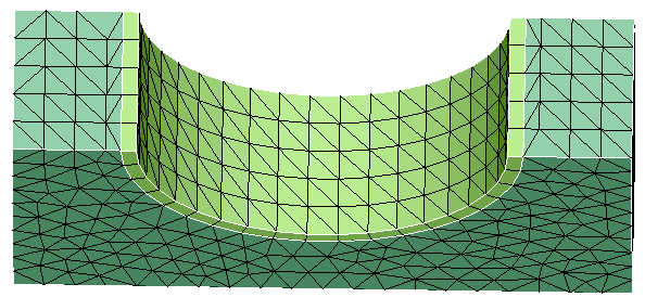

- Upto faces: This option is used to create layers between the selected faces and the limit faces. This option is supported only for tri elements with uniform layer thickness.

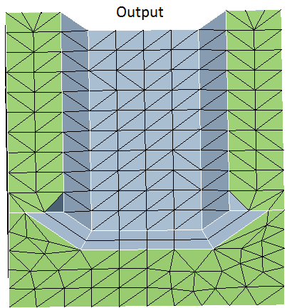

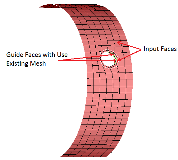

Example shown below, where the mesh does not follow the adjacent faces because of angle is more than 120 degrees.

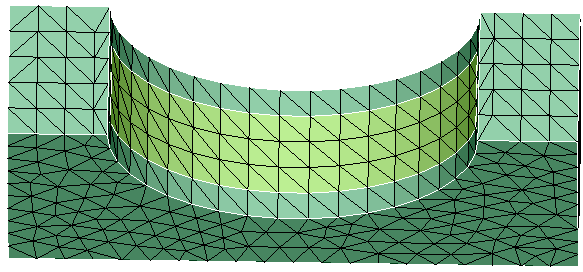

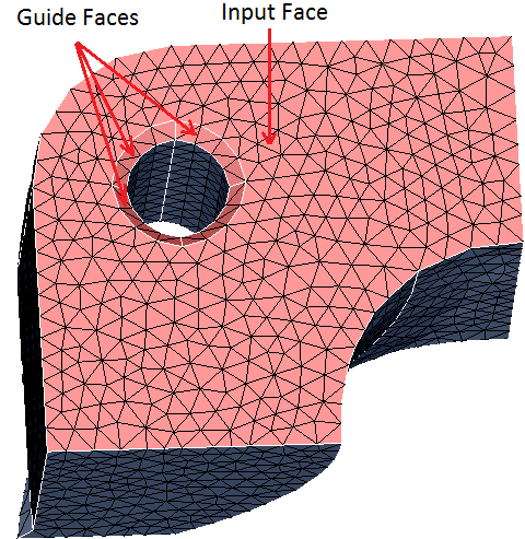

- Use existing mesh

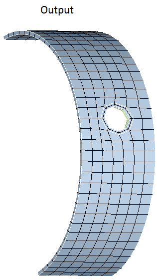

This option will be enabled only if Move along neighbor faces check box is activated. In this case we will use the mesh in the adjacent faces for the specified number of layers. Limitation in this option is that the adjacent faces should contain only iso quad elements.
- Adjust normal: This option will be enabled only if Use existing mesh checkbox is activated. Adjust normal is used to smooth the nodes in every layer by adjusting the normal of the nodes to get good quality elements.

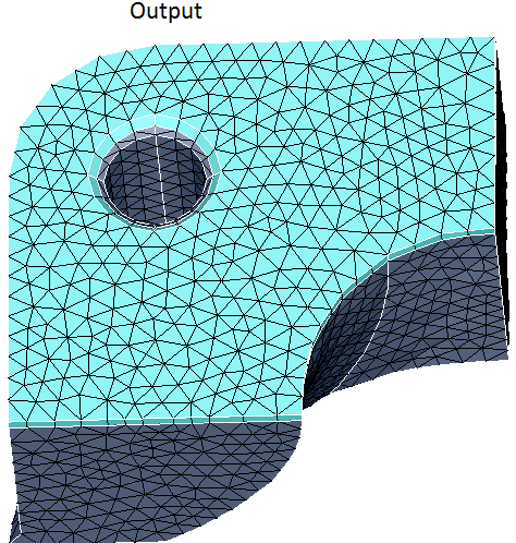

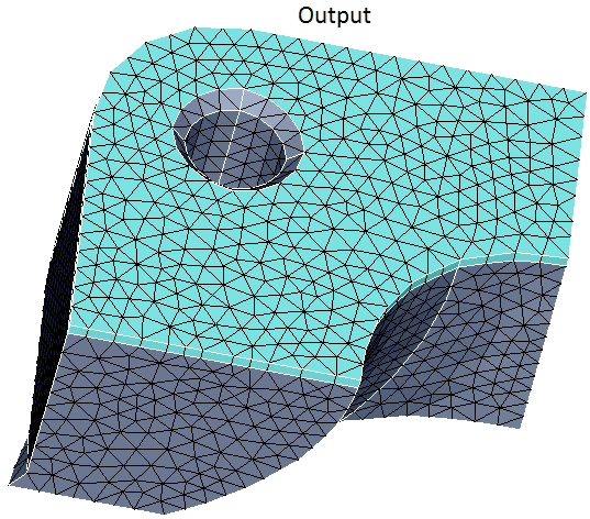

You can force the output mesh not to follow the selected faces.

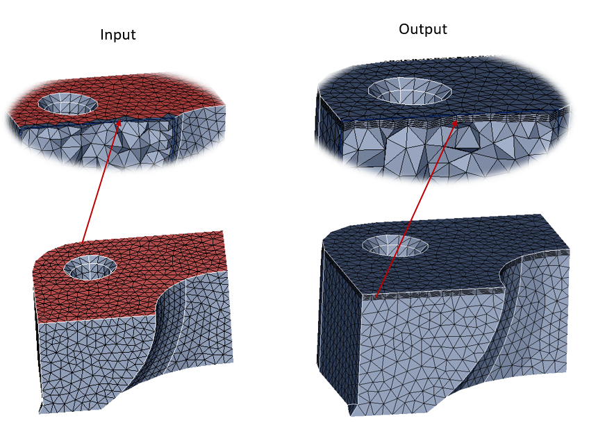

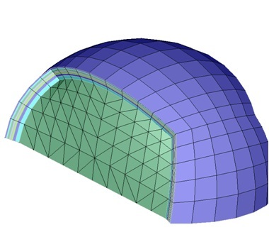

Layered elements on Tet solid body
Layered elements on Tet bodies, creates the Tet/Hex layers and locally modifies the Tet elements without changing the mesh in other locations. The number of Tet layers that have to be modified is controlled using the option Number of Tet-Element layers considered during local mesh modification available under File | preference | mesh. By default, 3 tet layers will be modified.
Hex/Penta layers are created in a separate body, whereas, the Tet layers are updated in the same body.
