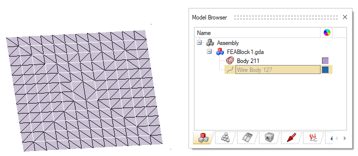

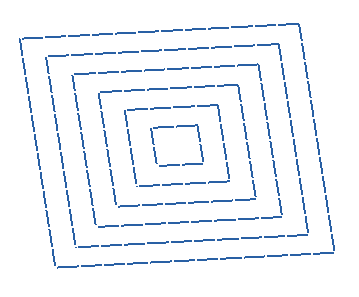

This option is used to create surfaces from wire bodies or edge loops.
Example
- Input
- Output
The created surfaces can be grouped to bodies as explained below.

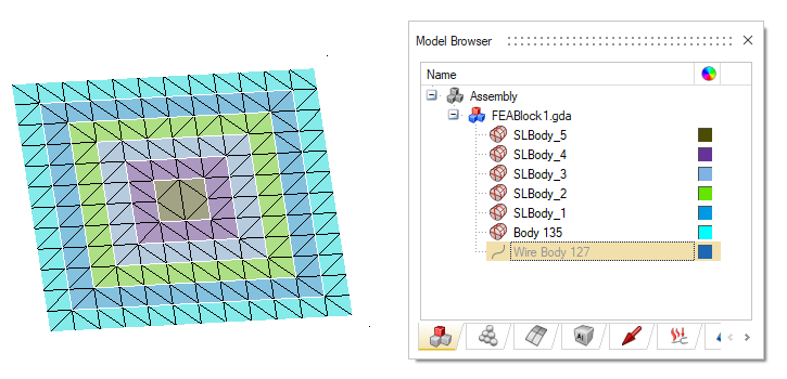

- Multiple bodies
Each filled loop is created as a separate body.

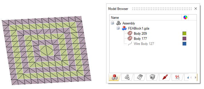

- Two bodies
Alternate filled surfaces from outermost loop is created as a separate body.
