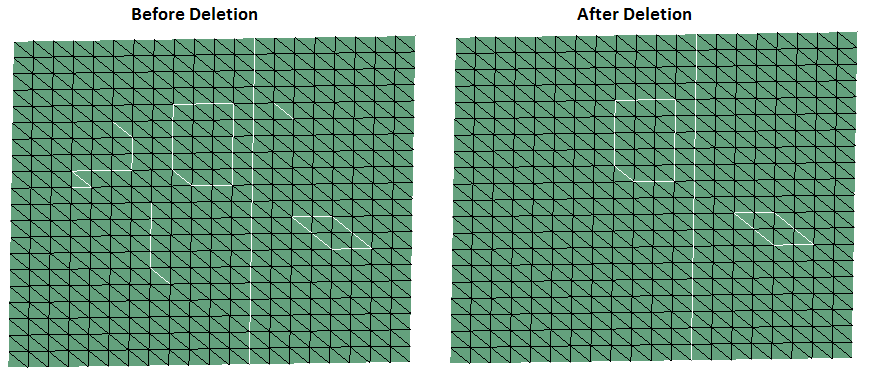

Floating edges
This option will remove floating edges present in the given set of bodies/faces. An edge that is not connected to any other edge and does not form a closed loop is called floating edge. An edge that is connected to another edge at only one end is also termed as floating edge.
Example

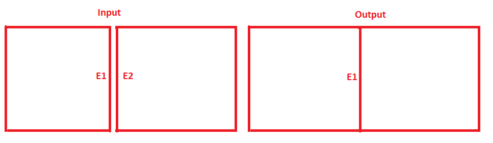

Overlapping edges
This option will remove overlapping edges present in the given wire bodies. An edge that lies over another edge either completely or partially is called overlapping edge.
Example
