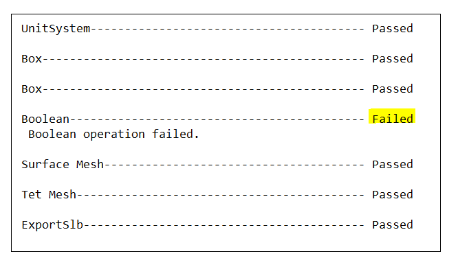

Without utility:
With utility:
In the preceding process, the Boolean operation encountered a failure. If the utility is not part of the script file, the execution proceeds through all operations. By using this utility, the script execution stops at the Boolean operation itself.
