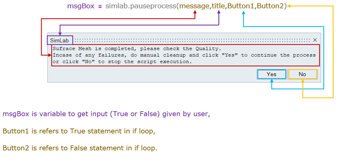

MessageBox = simlab.pauseprocess(message,title,Button1,Button2)

- To perform some manual operations in between scrip execution
- To alert the user with some warning / error / information
- Allow the user to skip the current process from execution
- Allow the user to select either process 1 or process 2 to execute

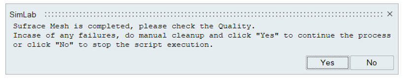

This utility is mostly used in semi automation process, where the message box will be posted in between script execution and it will ask for some input from user to proceed further.

User can use "\n" to move the statement to next line.

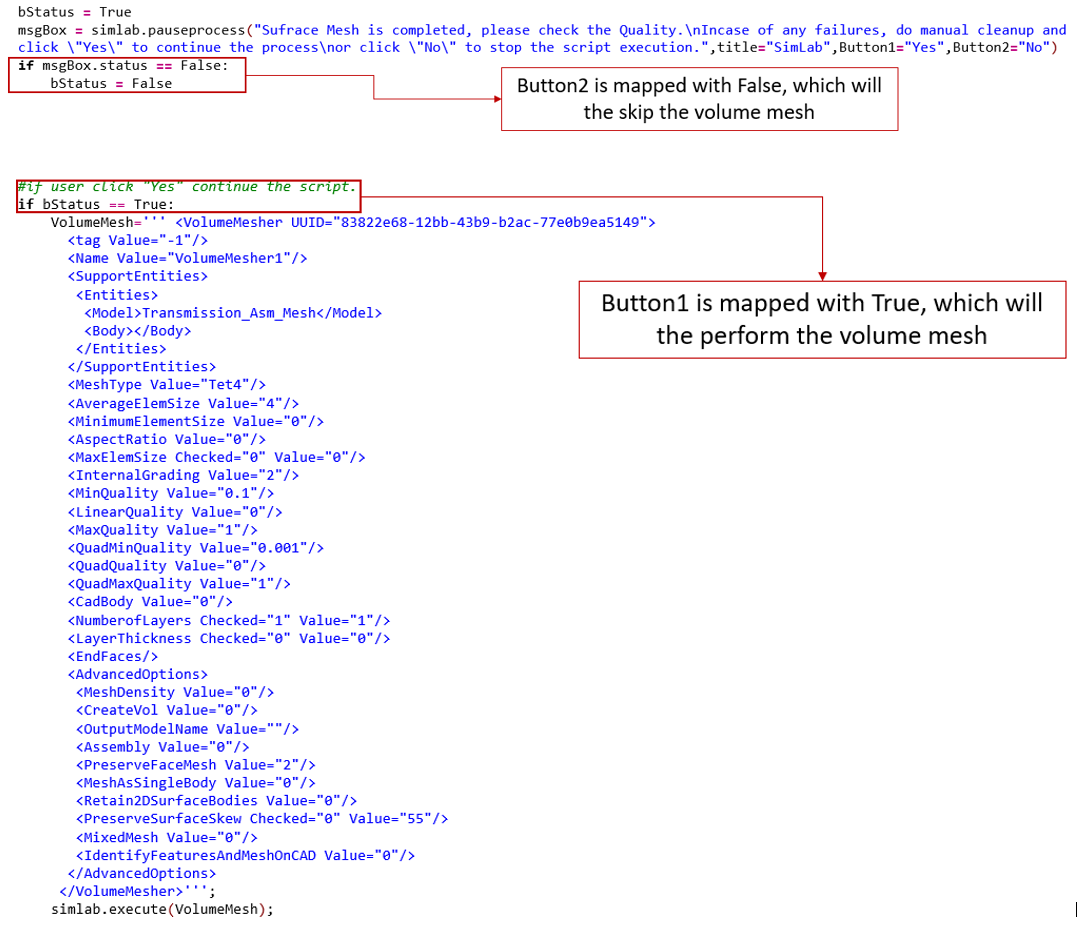

Sample
Note: Sample
Script
