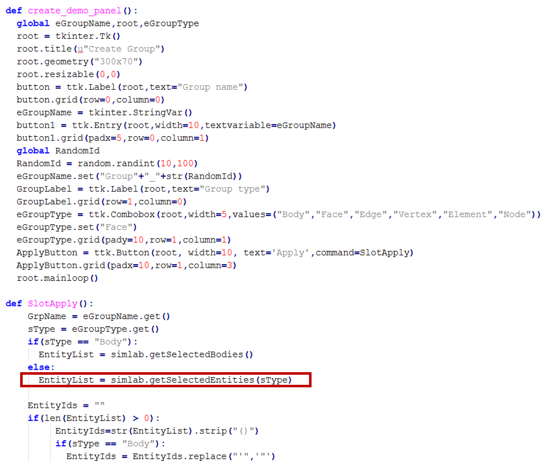

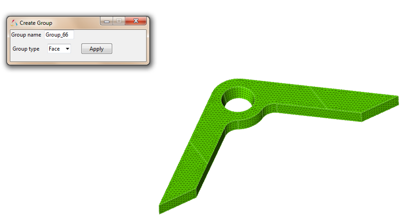

- In the below example the entities selected by the User is used to create groups
