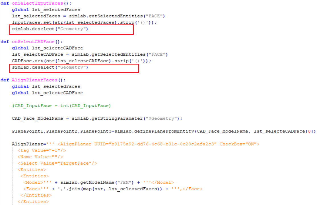

This utility used to clear the selected Geometry/FE/Group entities from the selection window.
Syntax
simlab.deselect(“Geometry or FEM or Group”);
where,
- Geometry - Clears selected bodies, faces, topological edges, and vertices from the selection
- FEM - Clears selected nodes, elements, and element edges from the selection
- Group - Clears selected groups from the selection
- simlab.deselect() - Clears all the selections
User Case
To manipulate the selections with the custom dialogs, For example, in the below case mesh faces aligned to the corresponding CAD face, after selecting the mesh faces this utility clears the selection so that the user can select the CAD faces to align.Sample
