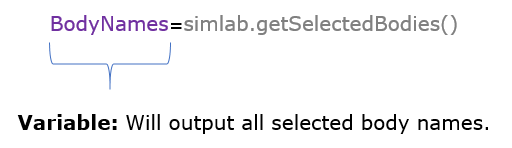

This utility is used to get the selected bodies to perform some operations.
Syntax
BodyNames=simlab.getSelectedBodies()

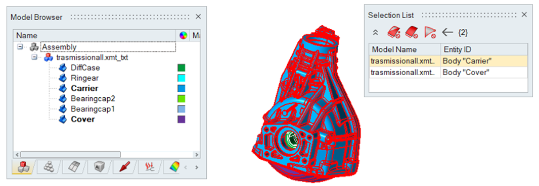

This utility is mostly used in semi automation process, where the bodies selected by a user can be identified by script and proceed further.The identified bodies can be given as input for further process like Create Group, Surface Mesh., that available in script.The body selection can be done while playing the script in interactive mode or use pauseprocess function to pause the script execution, select the required bodies and continue the script execution.

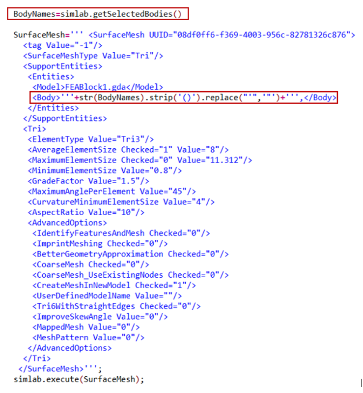

Example
After execution of this function, the variable will have.,BodyName = ('Cover', 'Carrier')This will return the body names as list, convert it as string like below.,BodyNames=str(BodyNames).strip('()').replace("'",'"')and this will returnBodyName = '"Cover", "Carrier"' now this variable is ready to use inside any function.
Sample
