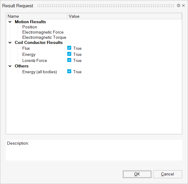

The Result Request allows the user to select the list of global quantities that he wants to postprocess in function of another parameter (position, time…).
Dialog Box
List of Result Request for EM Solutions
By default, the predefined quantities of the motion are displayed (and cannot be modified), and the user has the choice to add or remove the other quantities. The list of these proposed quantities is in this dedicated GUI and depends on the studied solution (MS2D, MS3D, MT2D...).
Export H3D Result files: this option has been added to support the exports or not of the graphical result contours for Magnetostatic Integral and AC Supplied Conductors. This option can help to save time in cases of Design of Experiments, when it is only interesting to see global values. This option is enabled by default.
