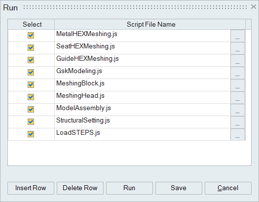

This option is used to list the scripts. These scripts can be selected and executed. This allows a process to stop and users to do manual operations before continuing with the rest of the process. This also allows users to break the complete process into sub process. An example is, where a thermal analysis script is to be run before a structural analysis run is performed which will require the results from thermal run. By click on the save button will save RunTemplate.xml file in the project folder. While opening the Run dialog next time, scripts present in the RunTemplate.xml file will be loaded in the Run dialog.

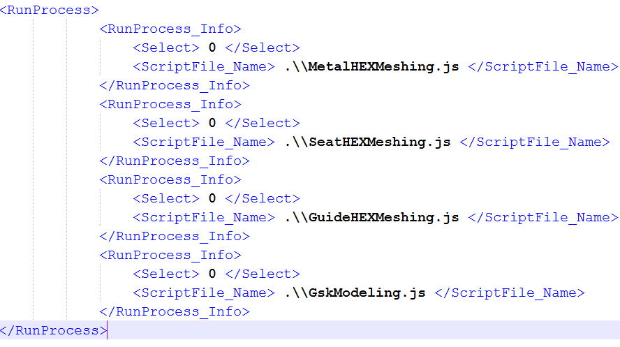

When selecting Save, an xml file (RunTemplate.xml) is created in the projetc folder.
A sample RunTemplate.xml file
