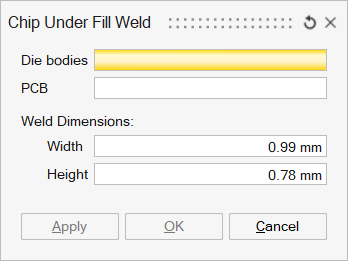

This tool is used to create welds between the PCB and the chips, dies and underfills on top of the PCB. Welds will be defined by the given width and height. This will create congruent mesh between the weld and PCB as well as the underfills, chips and dies. There will be mesh modifications on PCB alone.

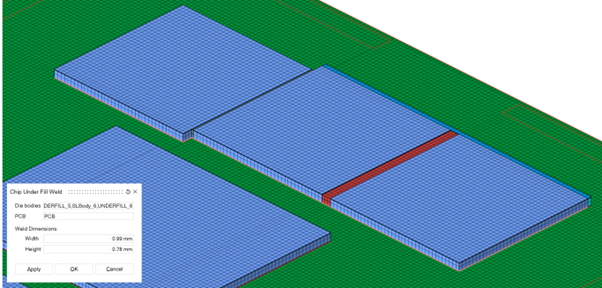

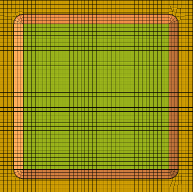

Example:Single chip
Input
Ouptut
Top view

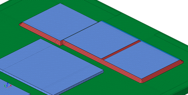

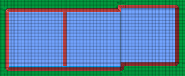

Example: Multiple chips
Input
Output
Top view
