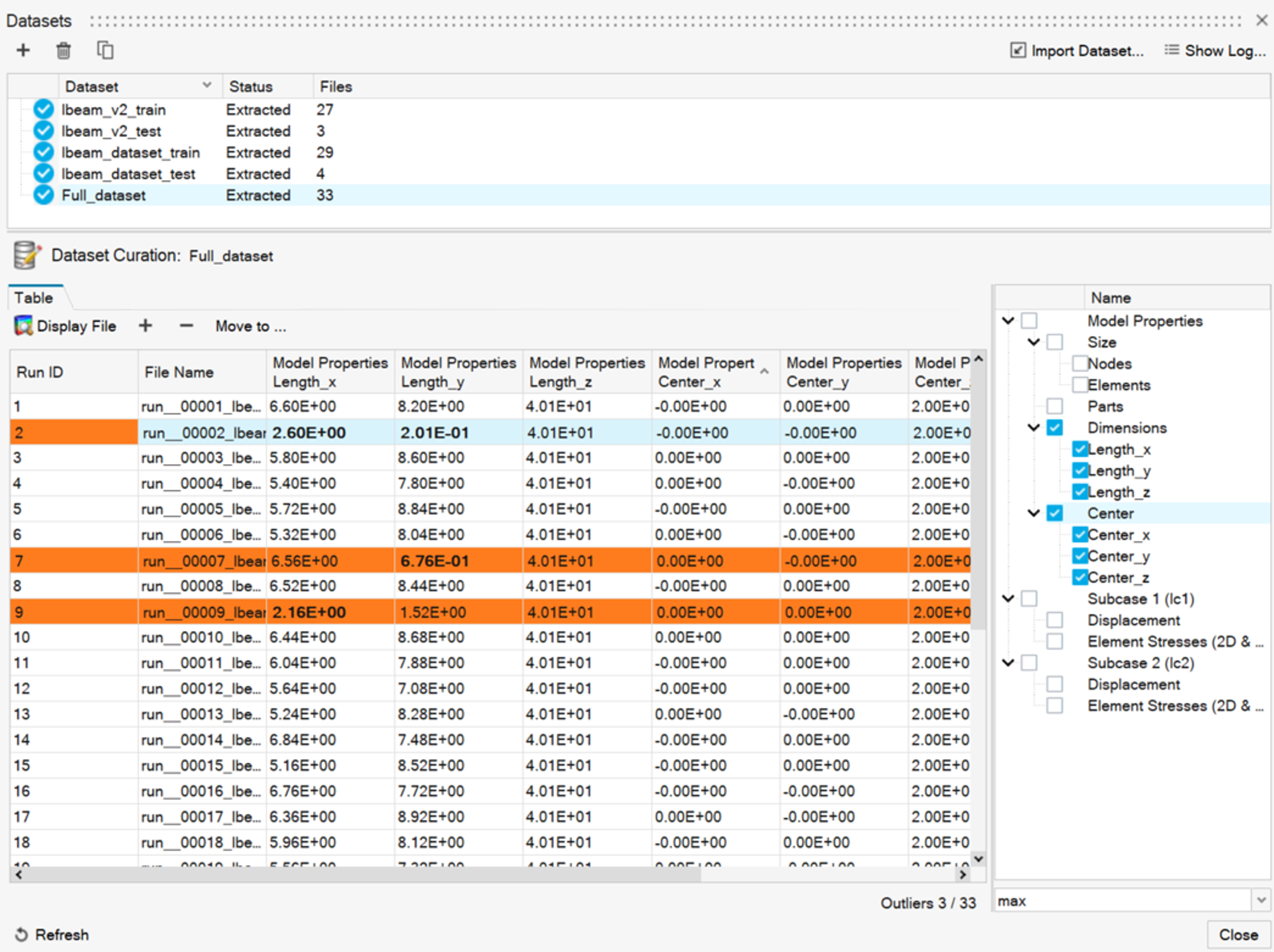

Identify Outliers
Outliers in the datasets are automatically detected based on one or more responses or model properties.
A Z-score distribution is used to highlight the samples which fall in 3-sigma tails.
  1. Select a dataset and properties.
  2. In Table to identify outliers in the tabular and graphical views.
  3. Compare data samples on multiple criteria by using side-by-side plots.
Edit Datasets
  1. In the tabular view, click to add datasets.
    The Add files to Dataset dialog opens wherein you can browse and select files to be added the dataset.
  2. Select files and click to remove data samples.
  3. Select files and click Move to to move them to other datasets.

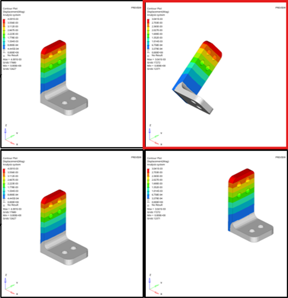

    Note:
    A potential source of noise is rotational/translational non-alignment of the data samples. While translational non-alignment can be corrected (see Train Models), rotational alignment cannot be corrected. To detect rotational outliers, the dimensions of the bounding box and coordinates of the center of gravity can be used.
