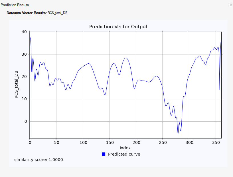

Similarity Score for Curves
When you make a prediction, PhysicsAI will quantify how similar the input design is to the training data in the form of a similarity score. In Simlab, the similarity score is displayed in python window for Field prediction and for the vector result it will be displayed in the plot window.

A similarity score of 1.0 indicates that the input design is the same as one of the training points. This is the maximum possible value.
