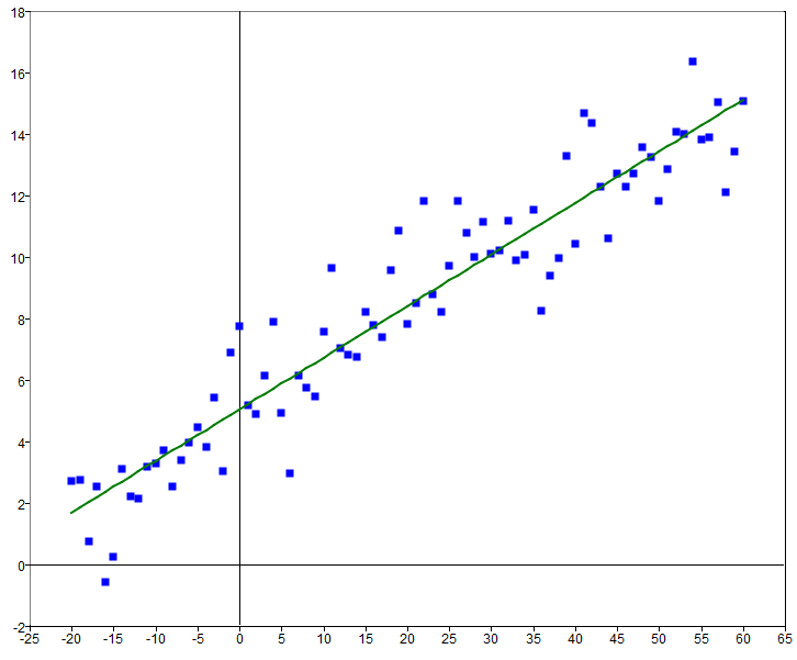

Consider the scatter plot of data below (Figure 1), along with a simple regression line of best Fit. Each scatter point represents a data point and the line represents the predicted values. The means the vertical projected distance from any point to the line is the error. This metric is a property of the predictive model and is true for any given point of prediction. In this plot, the MAE has a value of 1.0. Using the MAE as an estimate of predictive error, any given prediction may be off by 1.0 units (on average). For example, the predicted value at the far right of the curve produces a value approximately 15, while a prediction near the far left of the domain produces approximately 2. Using the MAE of the model as a reasonable estimate of error, both the right and left side predictions would have errors (on average) of 1.0. Note that these would result in different % errors (about 15% and 50% respectively).

clear all
clc
A= 5/30;
B= 5;
d = 8.235;
x = -20:1:60;
rand('seed',4);
y  = A*x + B + d*rand(size(x)).*(rand(size(x))-0.5);
yl = A*x + B;
function yf = func(p,x)
	yf = p(1)*x + p(2);
end
p = lsqcurvefit(@func,[A,B],x,y)
yl2= p(1)*x + p(2);
scatter(x,y);
line(x,yl2);
MAE=mean(abs(yl2-y))
