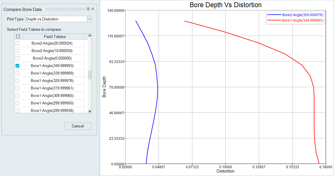

This tool is used to compare the Bore distortion results of multiple bores with plots.
In SimLab, we have the Bore distortion tool which is used to compute and analyze different bore profiles. Comparing these profiles with the other bores or the same bore with different operating conditions is in regular industrial practice. SimLab creates the Bore distortion results of each bore as SimLab tables. These tables further used to compare the multiple bores.
Compare Bores:
User can compare the results of multiple Bore distortion by following the below steps.
  • Perform Bore Distortion
  • Create Distortion Data as Tables
  • Compare
    Repeat the above steps for other bores and compare. Users can select the required field tables to compare. Users can manually create these field tables, with the experimental data if any, and compare with the FE results.
