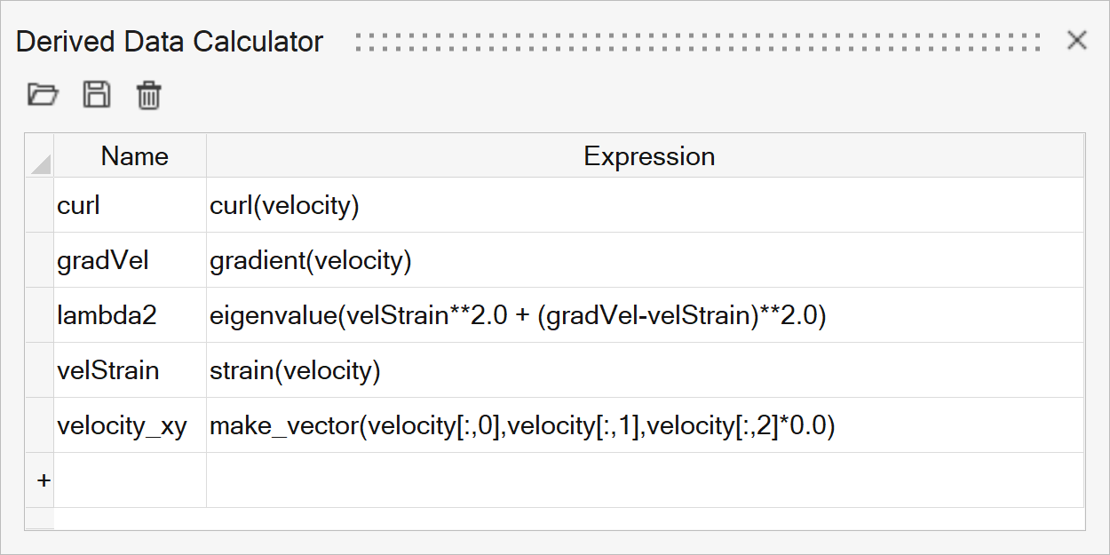

The Derived Data Calculator dialog opens.
- Define the name and expression.
- Define the name without spaces so that it can be utilized in further expression definitions.
- If using an existing variable with a space in its names, like “wall shear stress”, replace the spaces with “_”.
- Expressions are defined in python syntax.

| make_vector() | Creates a vector from three scalar fields | velocity_xy | make_vector(velocity[:,0],velocity[:,1],velocity[:,2]*0.0) |
Some functions above return vector and tensor quantities. At the current time, SimLab has no way to know a priori what the return dimension of a given function will be. As such, results may be unpredictable for complex expressions. The expression validation also becomes more complex as nested functions are used. It is best to use multiple fields to build up complex expressions. For example, to compute the Q-criterion, first compute the gradient of the velocity, then sum the gradients in a separate expression to evaluate Q:
| Name | Expression |
| gradVel | gradient(velocity) |
| Q_criterion | -0.5*( gradVel[:,0,0]*gradVel[:,0,0] + gradVel[:,1,0]*gradVel[:,0,1] + gradVel[:,2,0]*gradVel[:,0,2] + gradVel[:,0,1]*gradVel[:,1,0] + gradVel[:,1,1]*gradVel[:,1,1] + gradVel[:,2,1]*gradVel[:,1,2] + gradVel[:,0,2]*gradVel[:,2,0] + gradVel[:,1,2]*gradVel[:,2,1] + gradVel[:,2,2]*gradVel[:,2,2] ) |

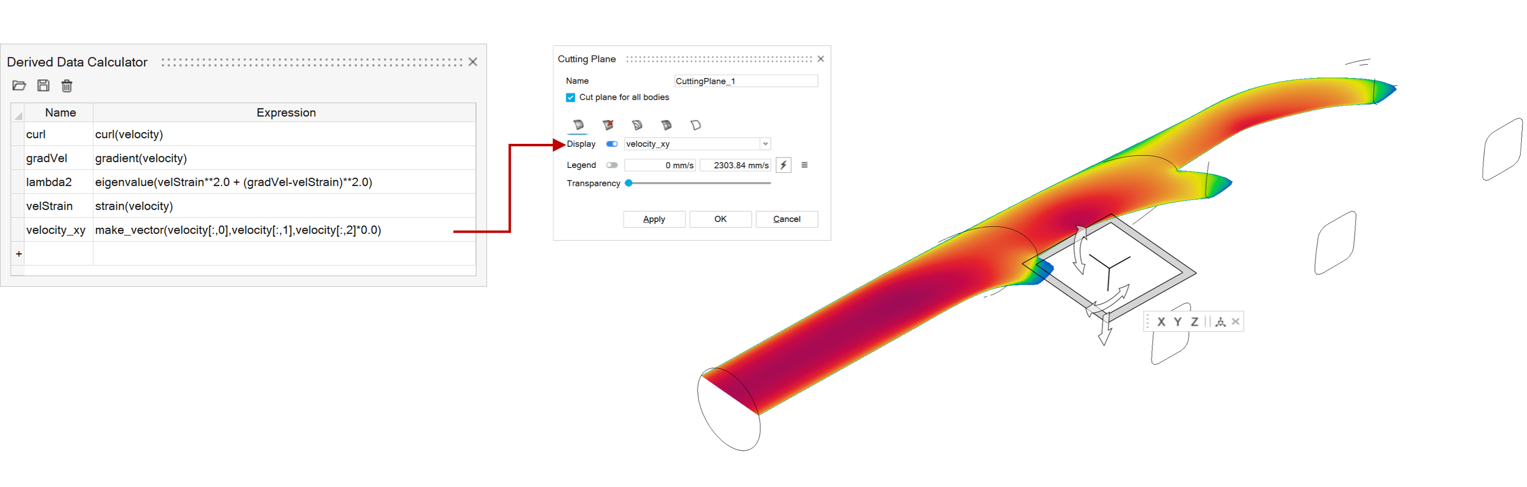

Example:
Usage of derived variable against a cut plane.
