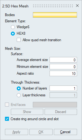

The global parameters to mesh a body with volume elements (Wedge/Hex) is specified using the 2.5D Hex Mesh dialog. The list of solid element types supported are,
  1. Wedge6
  2. Hex8
Wedge/Hex parameters
The parameters for Hex and Wedge is shown below.
"Allow quad mesh transition" option generates quad mesh with transition. For more details please refer Allow Quad Mesh Transition.
Surface
  • Average element size: Defines the average element edge length for the mesh on the surface.
  • Minimum element size: The mesh will have no elements with an edge length smaller than the minimum element size.
  • Aspect ratio: The quality of mesh can be controlled by setting the Aspect ratio.
Through Thickness
  • Number of layers: It specifies the desired number of layers along the thickness direction.
  • Layer thickness: It specifies the layer thickness along the thickness direction.
End faces
If the tool fails to identify the end faces for the given body, hex mesh cannot be created. In this situation user can give the end faces to generate hex mesh.
Show option identifies the end faces automatically and user can review and edit the selection manually. User can clear the end faces using discard option.
Create ring around circle and slot
This option will create one or two layers of elements around circles and slots. For more details, please refer Create ring around circle and slot.

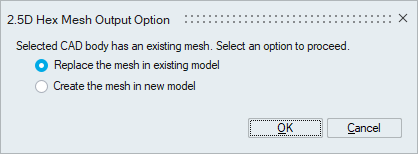

2.5D hex mesh output option for different inputs
  • FE Body: The output mesh will be created in a new model.
  • CAD Body: The below dialog will prompt the user to select the output location if an equivalent mesh is already present. For more details, please refer Mesh output options for CAD body.

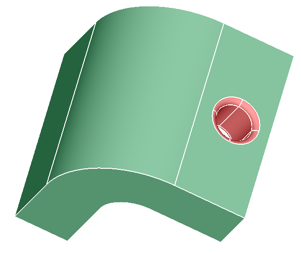

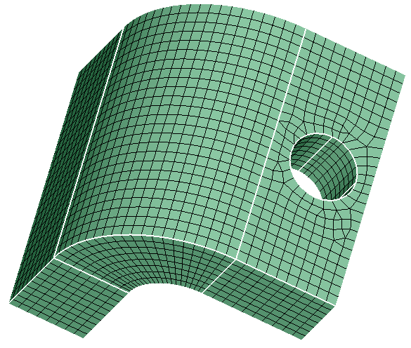

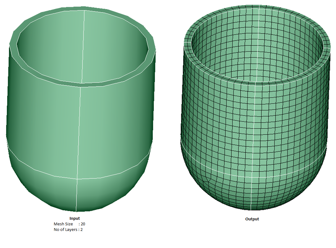

Example 1
Example 2: End face input
Input
Output

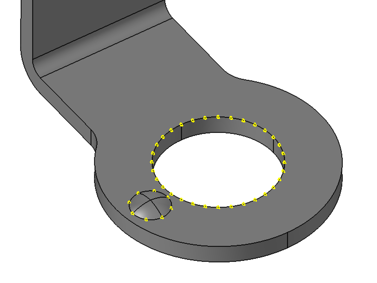

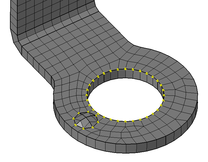

Example 3: Edge mesh control input
Input
Output
