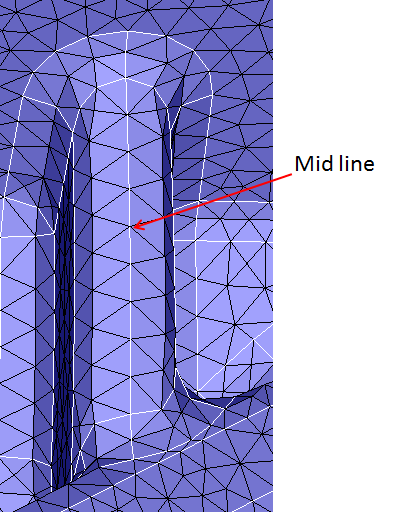

Mid line

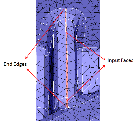

This option is used to collapse out the faces to its middle. End edges that define the thickness of thin faces are automatically identified during mid line creation. If it fails to identify, it will post an error message, you can use the button "Display End Edges" to identify and verify the end edges. If the identified edges are not correct, select or deselect to correct the input end edges.

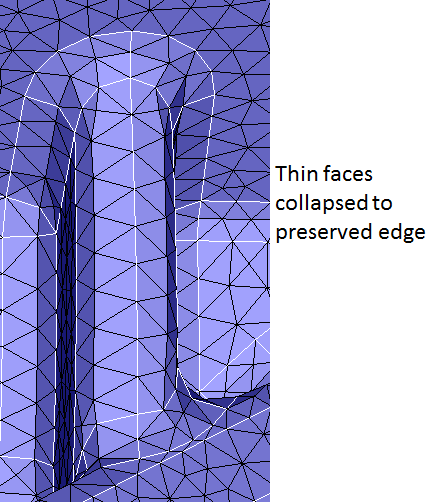

Selected edge
This option is used to collapse out the face to the given side edges that define the length of the face. The given side edges are preserved and the face is collapse out.
