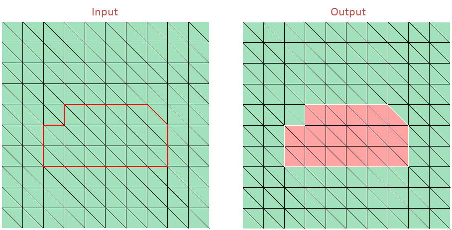

Example 1
set of element edges are given as input and a topological edge is created on those element edges as output. Face is broken in to two faces.

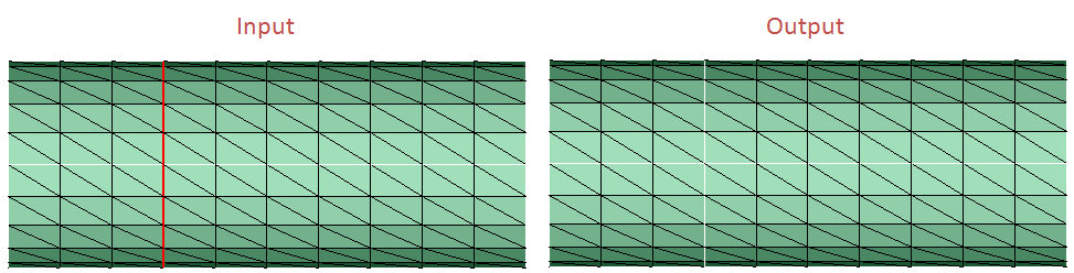

Example 2
In this example element edges are selected from multiple faces.
