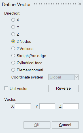

Define Vector
Dialog Box
This option is used to define a vector.
Direction
Choose the direction (X axis, Y axis and Z axis) and define the vector.
Vector can also be created by selecting 2 Nodes, 2 Vertices, Straight/Arc edges, Cylindrical face and Element normal.
Coordinate system: Local co-ordinate system can be listed here. This is present only for X, Y and Z directions. Vector can respond based on the local co-ordinate system we choose.
Unit vector
If Unit vector is ON, the vector will be scaled to have a unit magnitude.
Reverse
This option is used to reverse to vector direction.
