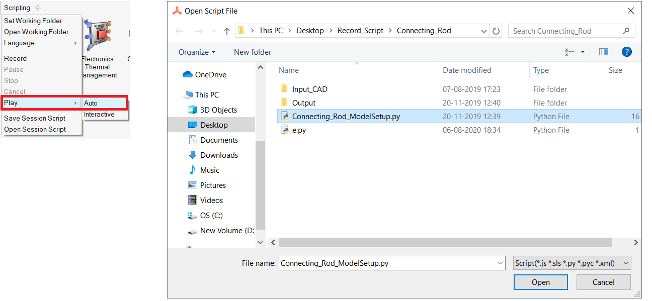

  1. Create a new database from File > New.
  2. Go to Scripting > Play > Auto. Select the "Connecting_Rod_ModelSetup.py" under "Connectin_Rod_Modelling" folder and click Open button.

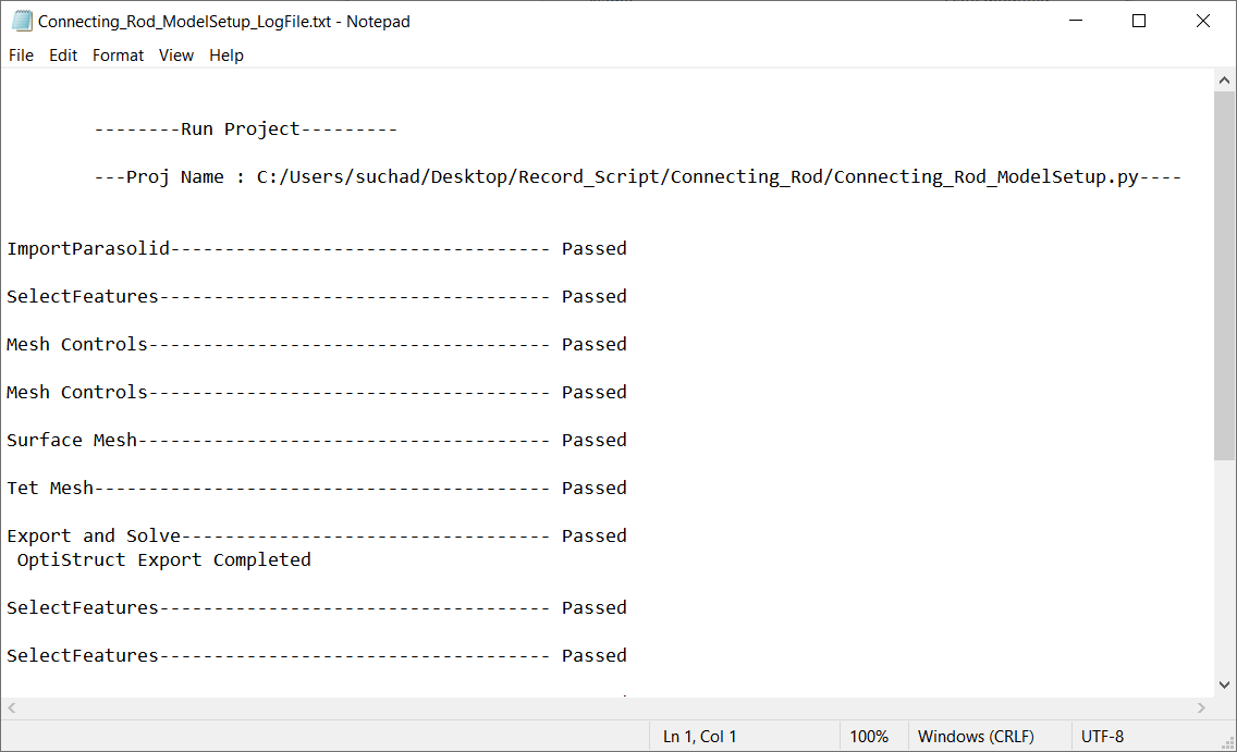

  1. Once the user selected the script through Auto Play option, SimLab will start execute the script process one by one automatically.
  2. User can check the status of script execution from "(Script File Name)_LogFile.txt" file that will be created automatically in script location itself while executing the script in Auto Play mode.
    This file is also used to identify the success and failure status of each, and every process executed from script.
