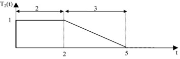

In case of transient application, it is possible to define the trapezoidal pulse function shown in the figure below.
Create an I/O parameter: PE = TRAPEZ (TIME,T1,T2,T3)
where:
  • TIME is the time parameter
  • T1 is the time interval of linear increase of the function
  • T2 is the time interval of constant value of the function
  • T3 is the time interval of linear decrease of the function
Example
An example of the TRAPEZ function is presented below.
Trapeze function: T2(t) = TRAPEZ (t,0,2,3)
