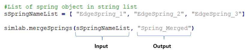

This utility is used to merge the existing spring.
Syntax
simlab.mergeSprings(sSpringObjectNameList, "MergedSpringName")
Use Case
This script utility can be used to merge the existing springs. The springs that need to be merged should have the same type, DOF, and stiffness values, otherwise, it will take the first spring type and values form the list and use it for the merged spring.
Utility Input
