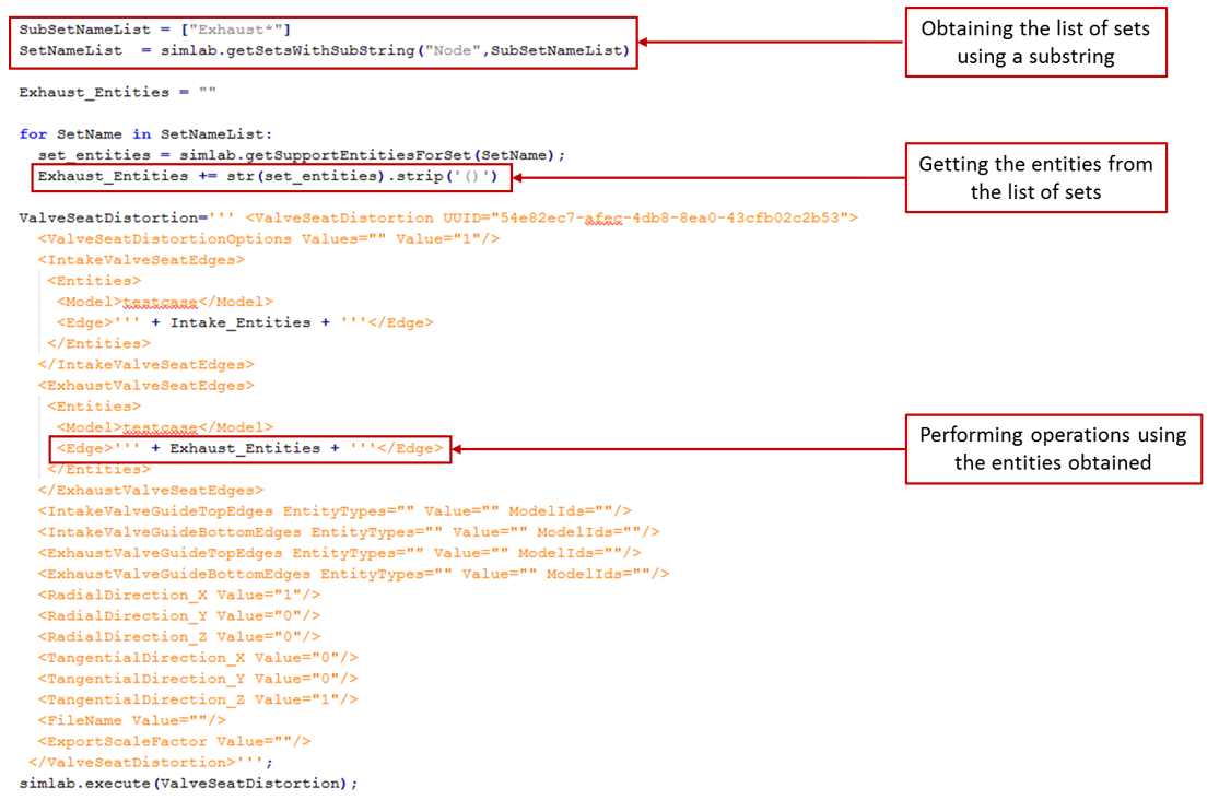

User Case
Below are some of the use cases where getSetsWithSubString will be useful to make the script generic.
- To perform post processing operations using the entities of set
- To Apply loads, contacts and boundary conditions using the sets and its entities
Why we need this utility?
In automation script, the entities are stored in sets with different names. These sets can be collected by specifying a sub string name. Based on set type it returns the set and then user can fetch the entities from set for further operations.

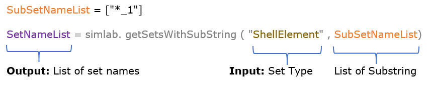

Utility Input/output
Sample
Note: Sample Script
