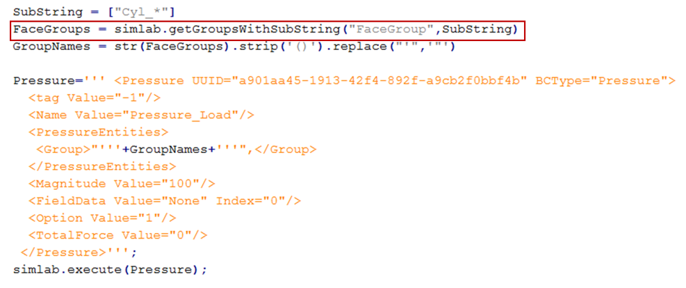

Utility Input/output
Sample
Note: Sample Script
