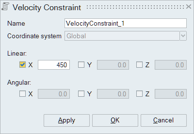

This tool is used to define Enforced velocity constraints for implicit/explicit motion or dynamic analysis.
Enforced Velocity constraints can be applied on nodes / faces / edges / vertices.
