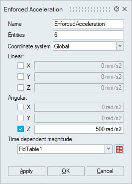

This tool is used to define Enforced Acceleration constraints for implicit/explicit motion or dynamic analysis.
  • Enforced acceleration can be applied on nodes / faces / edges.
Cards supported for various solvers
Solver Supported cards
OptiStruct SPCD, SPC1 id pointed in RLOAD#,TLOAD1(ACCE)
Abaqus *BOUNDARY, TYPE=ACCELERATION “Base Name” pointed in *BASE MOTION
