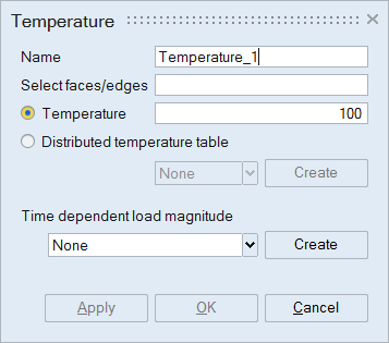

Temperature
This tool is used to define the temperature on edges/faces.
- Distributed temperature table option is used to apply
a spatially varying temperature load. An external file containing the
spatial data of the format X,Y,Z,TemperatureValue can be
imported.
Time dependent temperature can be defined by using Amplitude table.
