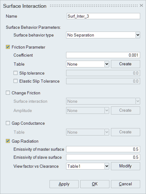

Interaction
This tool is used to define the interaction properties for contact analysis.
- The following surface behaviour types can be defined
- None
- No Separation
- Pressure Overclosure - Hard
- None
- Penalty - Linear
- Augmented Lagrange
- Pressure Overclosure - Tabular
- This option is used to define pressure-overclosure relationship.
- Pressure Overclosure - Exponential
- No Separation, Pressure Overclosure - Hard
- None
- Penalty - Linear
- The friction coefficient can be specified if required.
- The change friction option is used to change the friction properties of a surface interaction from step to step. Surface Interaction with change Friction can be included in a load case. The friction coefficient and amplitude table will be referred in change friction card (Abaqus only) in the respective step.
- The gap conductance is used to specify dependence of gap conductance on gap clearance/gap pressure and average surface temperature.
