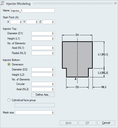

This tool is used to model the injector using tet elements. The injector has two portions such as injector top and injector bottom.
The injector modeling can be done using two methods,
  • Dimension
  • Cylindrical face group
Dimension
This option is used to model the injector by entering the parameters of the injector top & bottom.

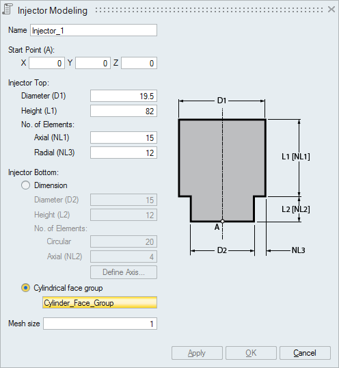

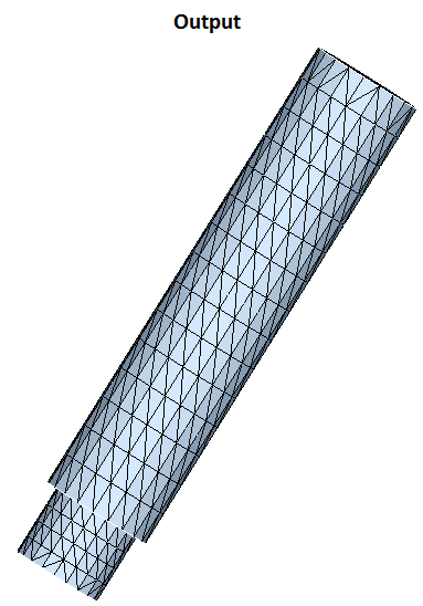

This option is used to directly get the dimension of the Injector bottom from the cylindrical face group selected. This will automatically get the values of D2, No. of Elements, L2, NL2 and axis from the face group selected. But the parameters of injector top has to be entered.
