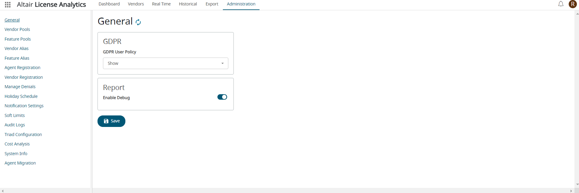

Click Administration tab.
Figure 2. Administration Tab

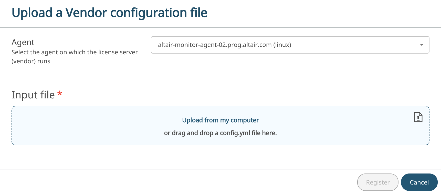

Click .
Upload a vendor configuration file is displayed.
Figure 4. Upload a Vendor Configuration File
- Select the Agent to which the vendor must be registered.
Upload the vendor configuration file.
The vendor configuration file can be created using the templates provided at:

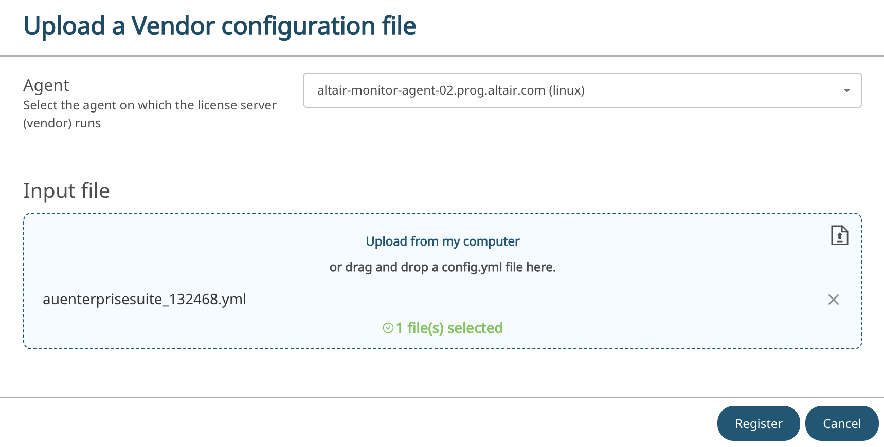

Figure 5. Uploaded Vendor Configuration File

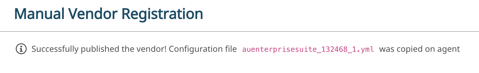

Click Register.
The following message is displayed after registration.
Figure 6. Vendor Registration - Complete

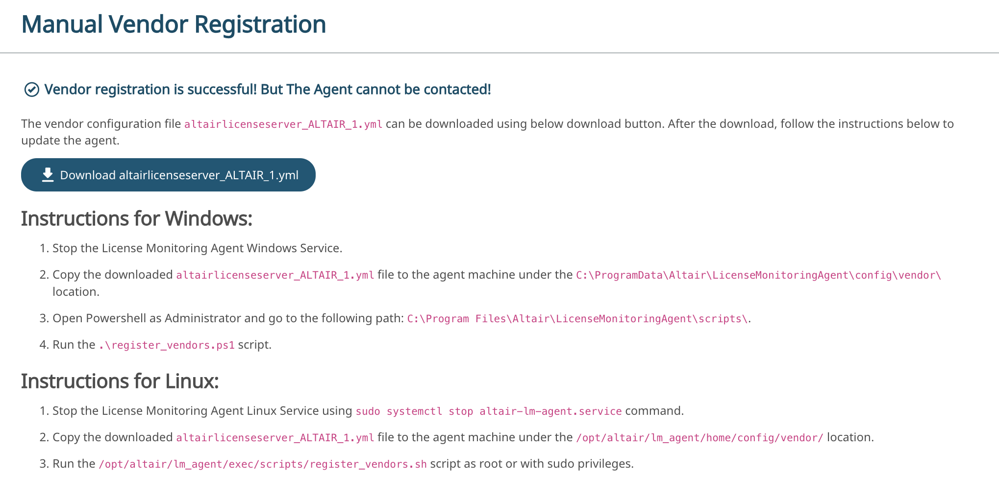

As the agent is connected, the server will publish this vendor information to the agent and the agent will start tracking the vendor along with other vendors.In the case of the air-gapped agent: the vendor details will only be saved on the server side. Administrator must follow the instructions provided in the Manual Vendor Registration to provide the vendor configuration to the air-gapped agent.Figure 7. Manual Vendor Registration
