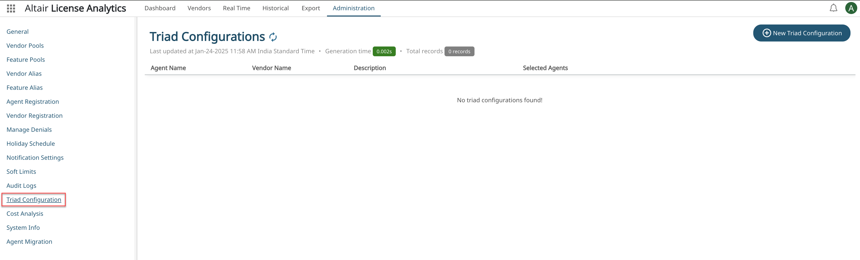

Click Administration tab.
Figure 2. Administration Tab
Click Triad Configuration in the menu.
The Triad Configuration list is displayed.
Figure 3. Triad Configured List
Click New Triad Configuration.

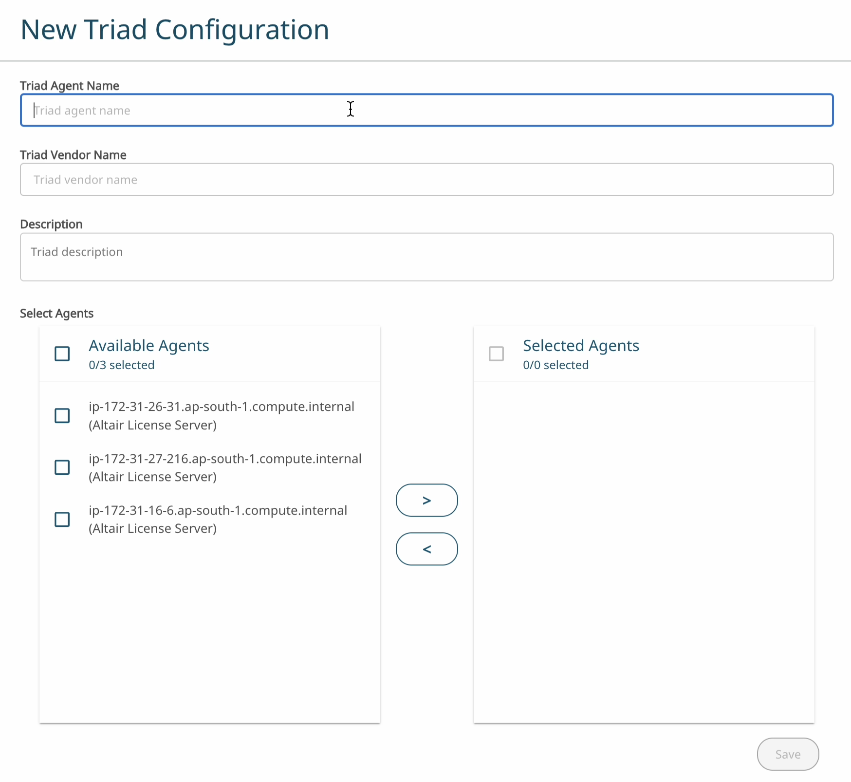

New Triad Configuration from is displayed.
Figure 4. New Triad Configuration
Note: The agents listed under triad will be single vendor agents only. Agents with multiple vendors will not be listed for triad selection. -

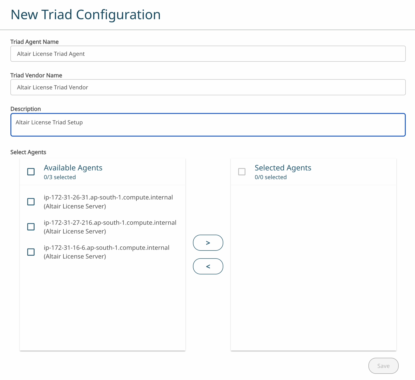

Enter the Triad Agent Name, Triad Vendor
Name, and Description for your Triad
Configuration.
Figure 5. Triad Configuration - Information

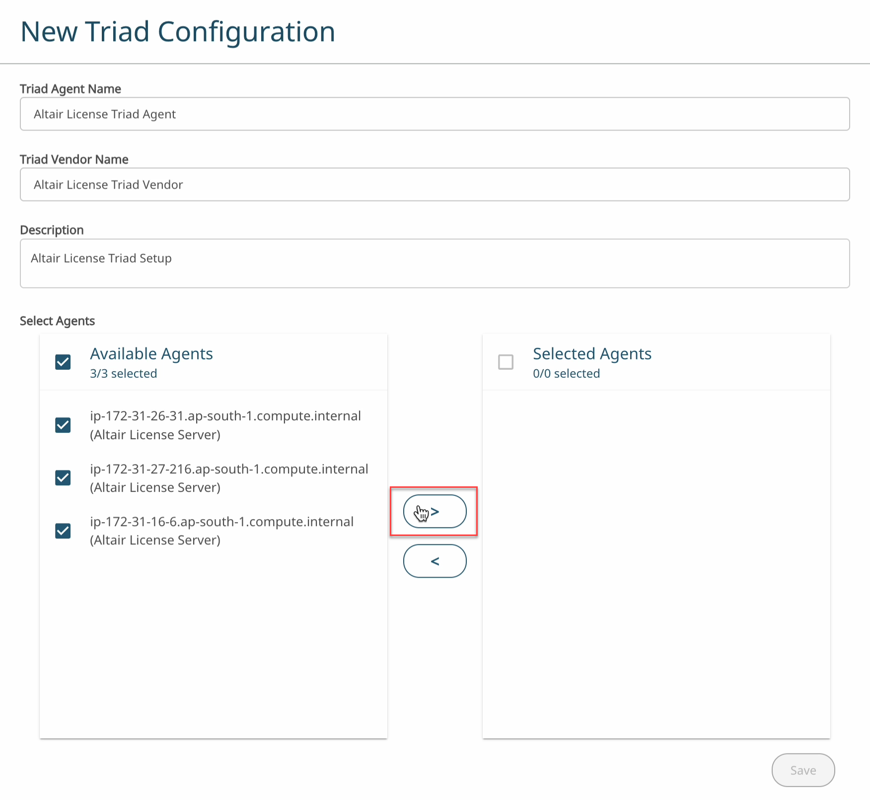

Click
to select the agents from the
Available Agents list to Selected
Agents list.
Figure 6. Select Agents
Click Save to create new Triad Configuration.
Figure 7. Triad Configuration - Save
The new Triad Configuration will be listed.Figure 8. New Triad Configured List
The triad vendors will be displayed in the report filters.
