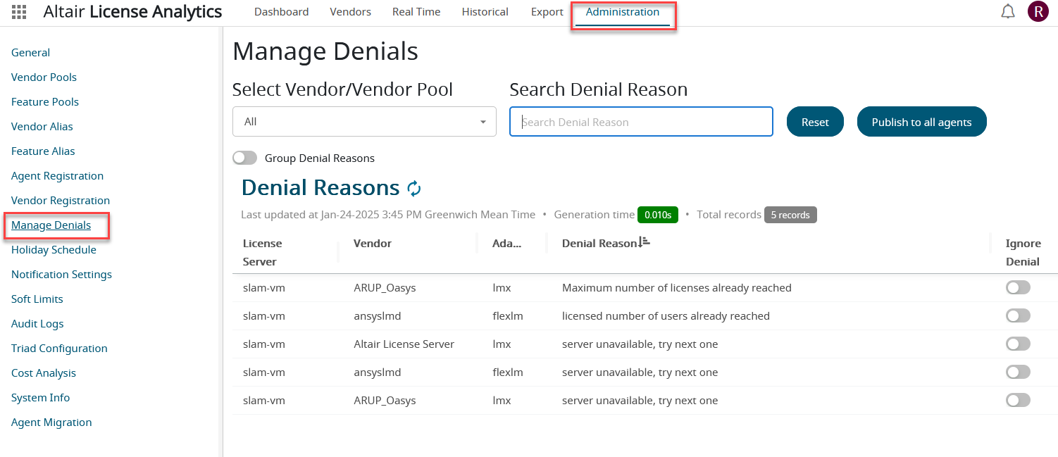

Login to the InsightPro for License Analytics portal using your credentials.
The Altair Licensing Analytics dashboard is displayed.
Figure 1. Altair Licensing Analytics Dashboard
Click .
Figure 2. Administration Tab - Manage Denails

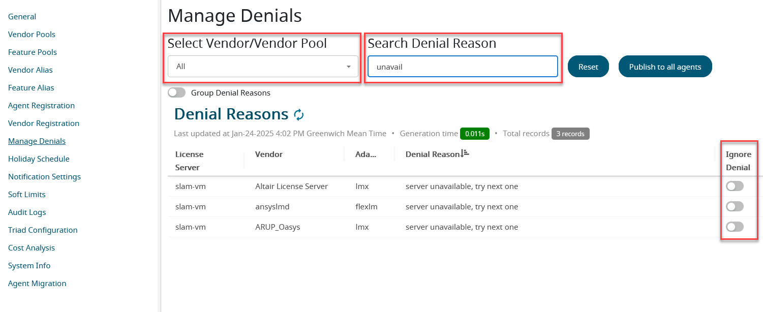

Predefined view displays the denail reasons reported by all vendors. - Select a particular Vendor or a Vendor pool from the Select Vendor/Vendor Pool drop down list.
- Toggle the button in the Ignore Denail column to exclude some denial reasons that you want to ignore.
Search denials by specifying key words in the Search Denial
reason.

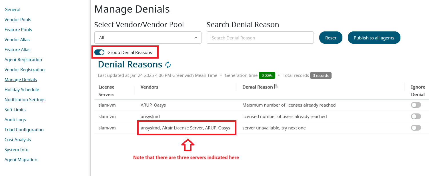

Toggle Group Denail Reasons button to group vendors by
denial reasons.
If there are several vendors which have denials with the same denial reason, then this option will ignore them without the need to acting on all the switches of each vendors, but acting only on one switch.

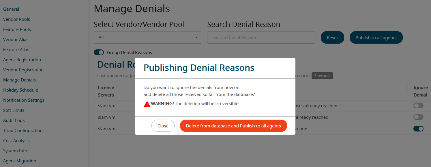

Click Delete from database and Publish to all agents to
confirm the publishing denail reasons.
The following actions will be performed:
- all denials with a denial reason corresponding to those selected will be
deleted from the database. Note: This action is irreversible.

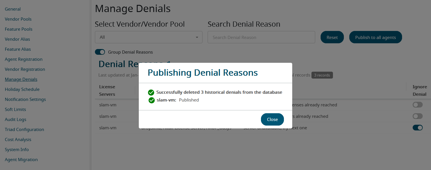

The following report will be displayed with the total number of denials removed from the database and the list of agents where the file was sent.Figure 6. Publishing Denial Reasons Report
This action can be reverted by creating a new denail options and publishing it to all the agents. This will ensure that the denials for that reason that are encountered in the future will no longer be ignored and will return to being registered in the database.Note: Denials that were ignored before this action will not be restored as they were deleted. - all denials with a denial reason corresponding to those selected will be

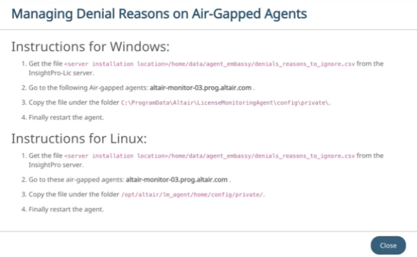

To Manage Denials for Air-gapped Agent
