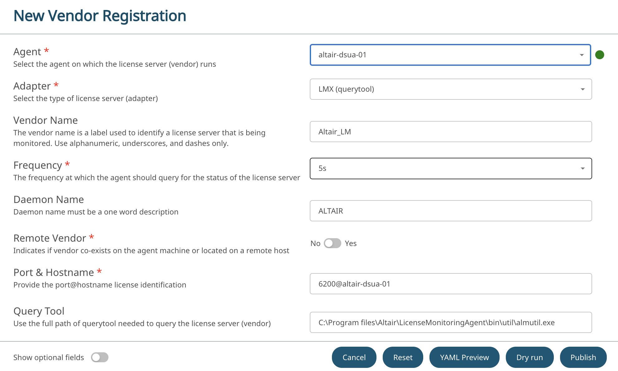

  4. Click Register a Vendor > Manually Register a Vendor.
    Vendor registration form is displayed.
    Figure 4. New Vendor Registration

  5. Select the Agent on which the vendor registration needs to be done.

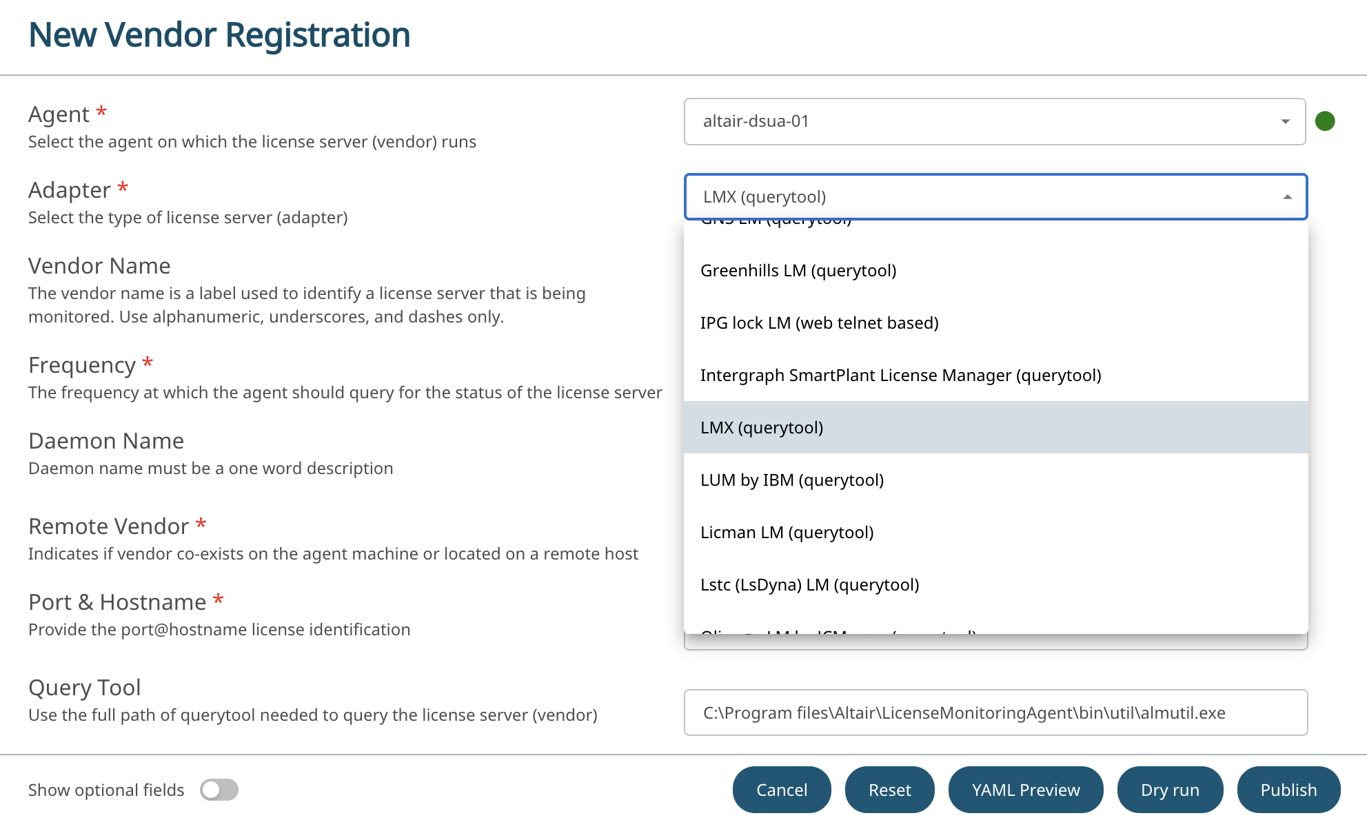

  6. Select the Adapter type.
    Figure 5. Adapter Type
    Note: The input parameters will change based on the Adapter that is selected.
  7. Enter the Vendor Name.
  8. Enter the Frequency at which the licencse statistics must be queried.
    Note: By default the frequency is set to 5 seconds.
  9. Enable Remote Vendor if you want to register a license server that does not exist in the agent machine.
  10. Enter the Port & Hostname value for license server identification.

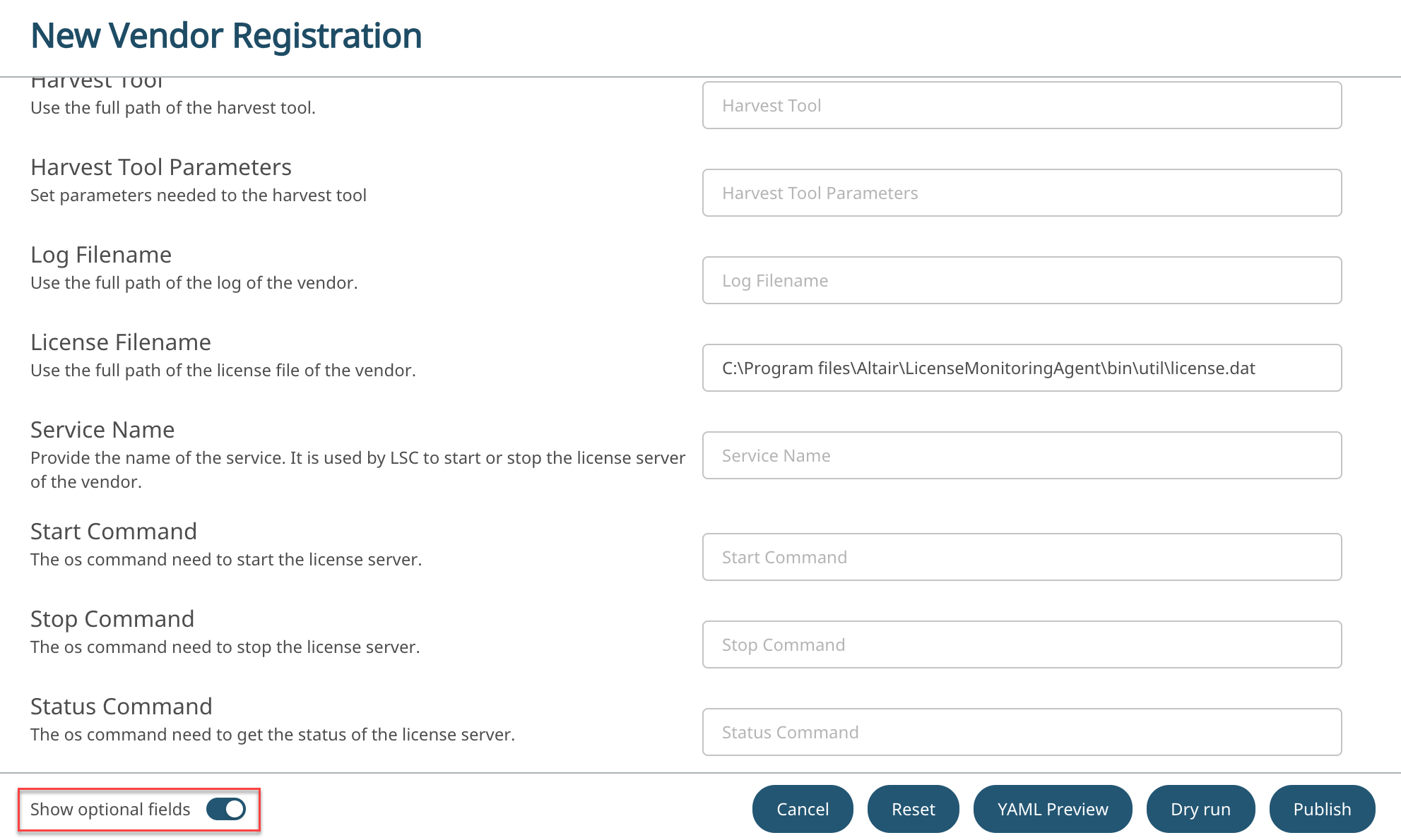

  11. Enter the values for the following mandatory fields:
    • Query Tool - Path of querytool needed to query the license server (vendor).
    • Query Tool Parameters - Parameters needed to query the license server (vendor).
    • License Filename - Path of the license file of the vendor.
    Note: Toggle Show optional fields button at the bottom to view and enter all the optional parameters.
    Figure 6. Optional Parameters

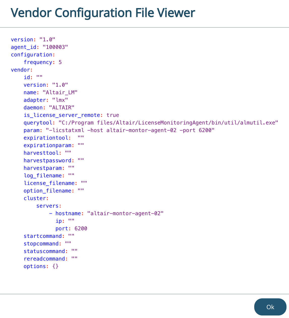

  12. Click YAML Preview to view vendor configuration file saved on the agent.
    Figure 7. Vendor Configuration File

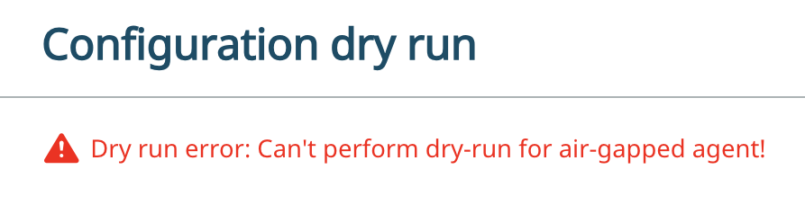

The following error message will be displayed if you click Dry run
Figure 10. Dry Run - Error Message

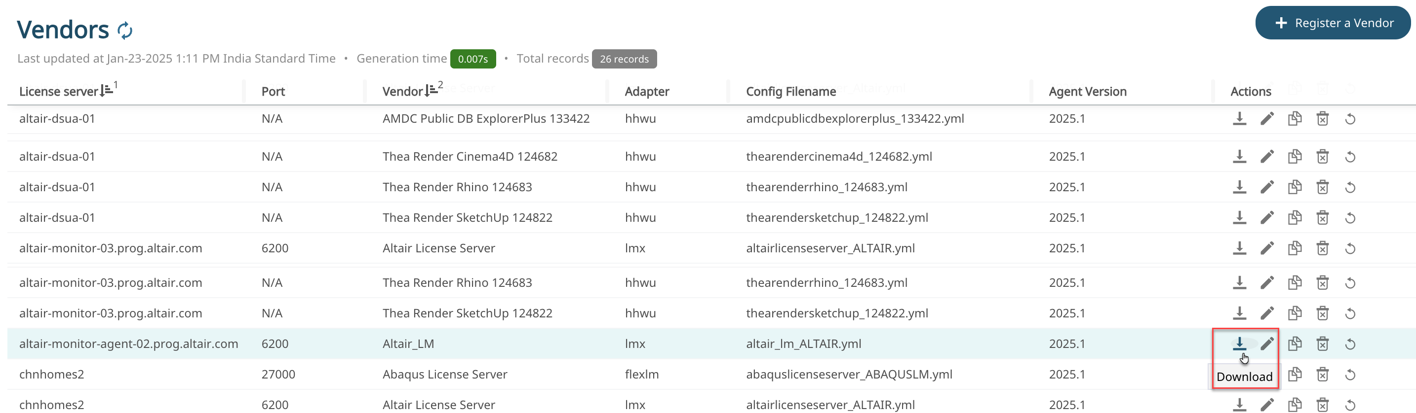

Administrator must download the vendor configuration file and copy it to the Air-gapped agent.
Figure 11. Download Vendor Registration Form

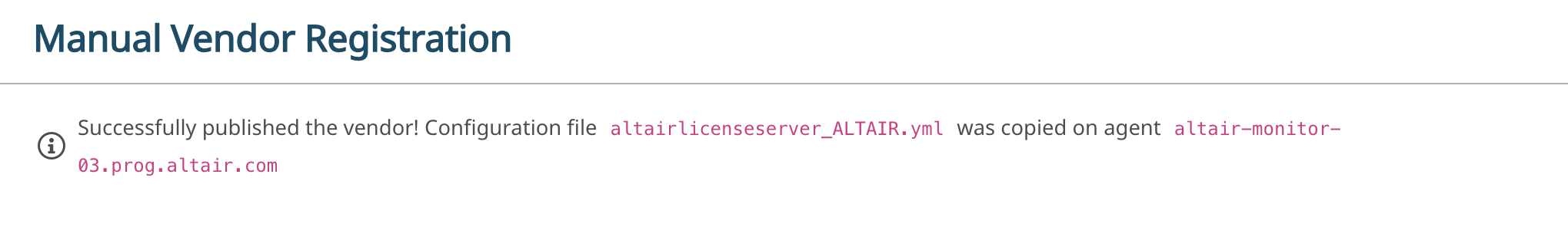

Administrator must follow the instructions provided in the Manual Vendor Registration to upload the vendor registration form to the air-gapped agent.
Figure 12. Manual Vendor Registration
