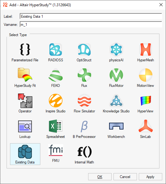

Perform the Study Setup
In this step, you create a study, add a model, and import .h3d files.
- Launch HyperStudy.
Start a new study in the following ways:
- From the menu bar, click .
- On the ribbon, click
Add a model.

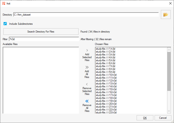

- In the Solver Input File field, enter arm.h3d.
Import .h3d files.

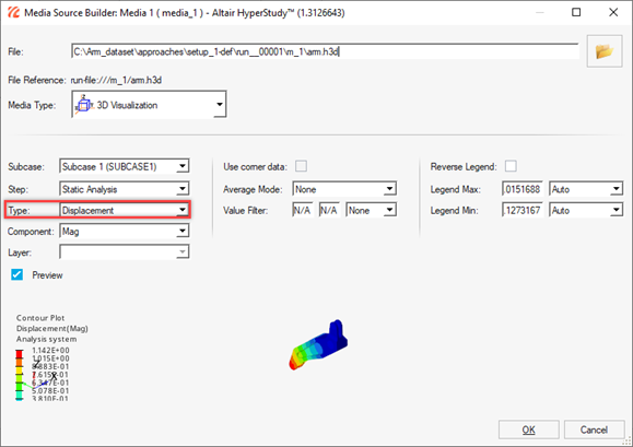

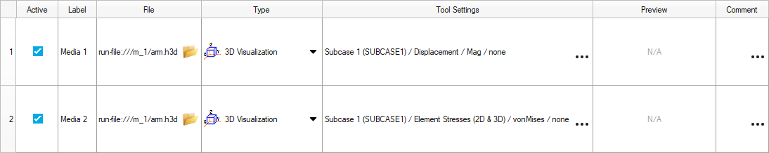

Create 3D Visualization
- From the Model Tree, click to open the Define Output Responses task.
- From the Media Sources tab, click Add Media Source.
In the File field, click
and browse
and select the arm.h3d file in
setup-run001\m_1.
In the Tool Settings field, click
The Media Source Builder dialog opens. -
For Type, select Displacement and click
OK.
Figure 3.
Add a second media source by repeating steps 2 - 5, but select Element Stresses (2D & 3D) as the
Type.
Figure 4.

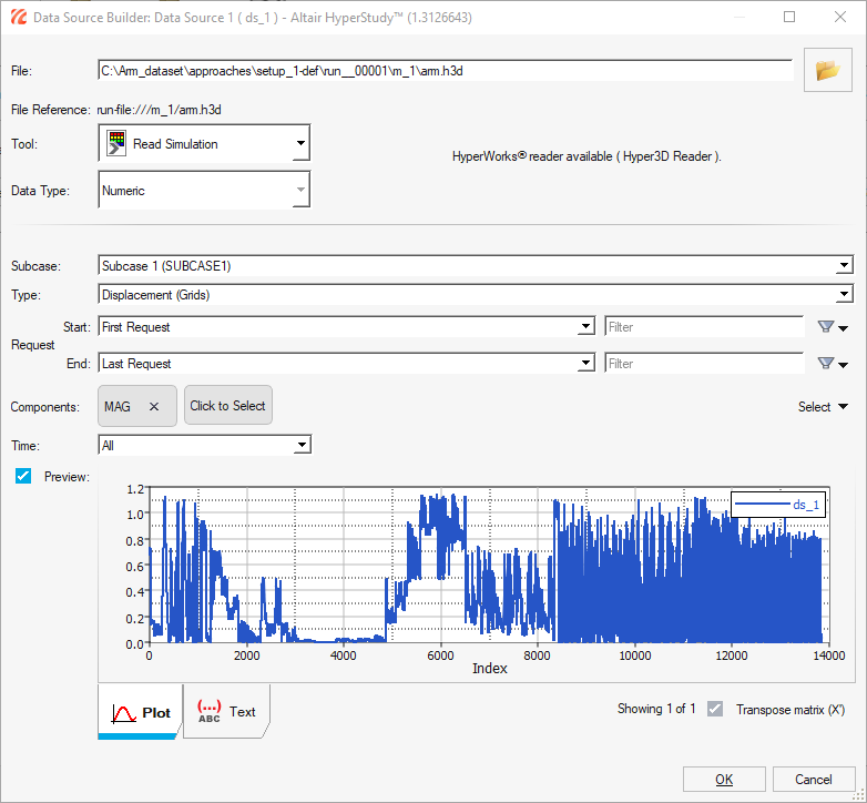

- From the Data Sources tab, click Add Data Source.
The Data Source Builder dialog opens. -
and browse
setup-run001\m_1.
- For Tool, select Read Simulation.
- For Type, select Displacement (Grids).
For Components, select MAG.
Note: This reads all the displacement values for all the nodes into a single vector from which values can be queried.
Click OK.
Figure 5.
Create two more data sources using the information in Table 1 by repeating steps 1 - 7.
Table 1. Data Source Details File Tool Type Components arm.h3d Read Simulation Element Stresses (3D) vonMises (2D & 3D) arm.h3d Read Simulation Element Strains (3D) vonMises (2D & 3D) Figure 6.

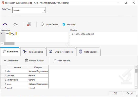

Create and Evaluate Output Responses

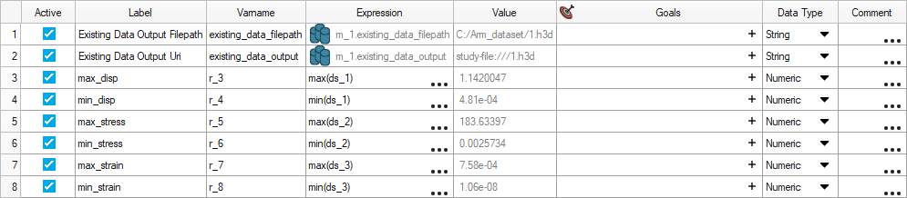

- From the Define Output Responses tab, click Add Output Response.
- In the Label field, enter max_disp.
In the Expression field, click
The Expression Builder dialog opens. -
In the Expression field, enter max(ds_1).
Note: Verify that ds_1 corresponds to the data source for displacement.
Figure 7.
- Click OK.
Create five more output responses using the information in Table 2 by repeating steps 1 - 5.
Table 2. Output Response Details Label Expression min_disp min(ds_1) max_stress max(ds_2) min_stress min(ds_2) max_strain max(ds_3) min_strain min(ds_3) -
Click Evaluate.
These are the six KPIs on which the training points can be evaluated.

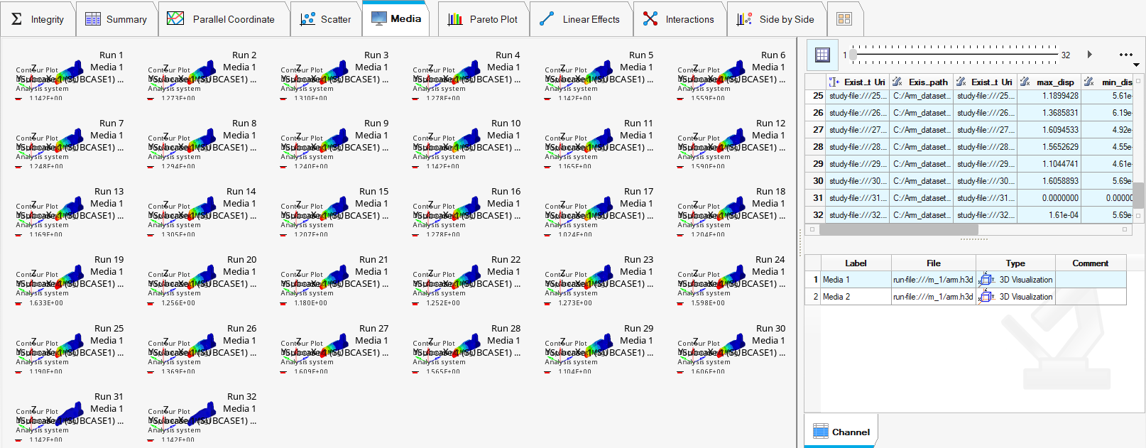

In the Media tab, review the evaluation results.
All the training files can be simultaneously loaded. You can inspect the plots visually using the media sources created earlier. As seen in , run IDs 31 and 32 have erroneous displacement and stress values. Hence, they are clear outliers.
Figure 9.

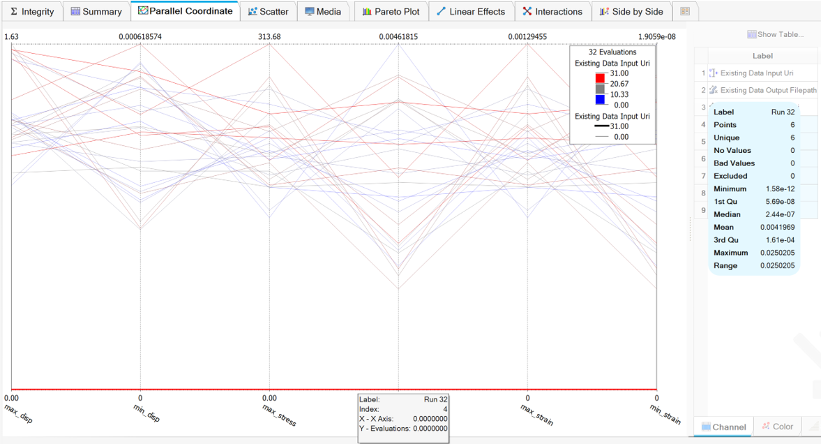

In the Parallel Coordinate tab, inspect the training data using the KPIs and
select the metrics created in step 6 of Create and Evaluate Output Responses.
Again, runIDs 31 and 32 are clear outliers.
Figure 10.

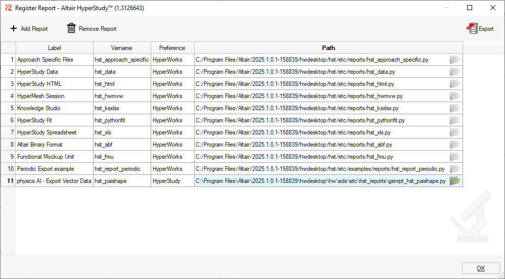

Generate Json Files
In this step, you will generate the .json files required for custom global inputs and outputs by using the genrpt_hst_paishape.py extension in the installation directory of HyperMesh.
If necessary, load the genrpt_hst_paishape.py
extension.
- Go to the step.
- Select physics.AI - Export Vector Data and click Create Report.
